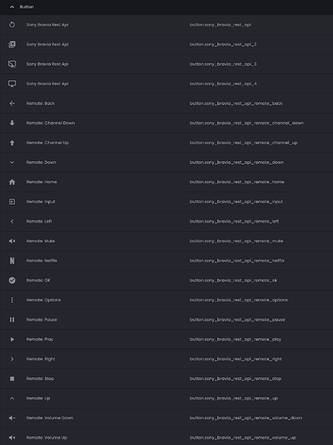

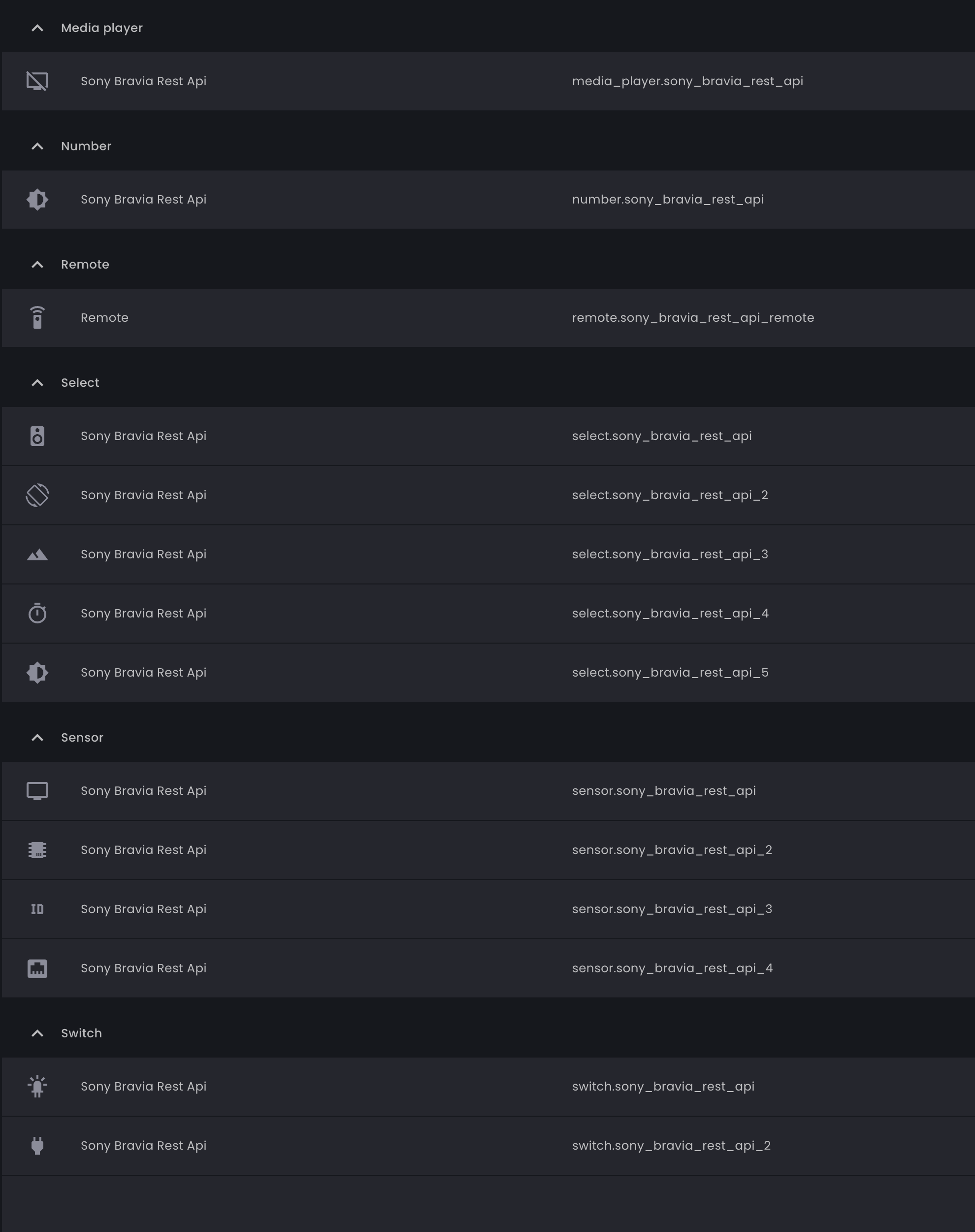

Hi @cmos486 Thanks for the integration, it will definitely make automating our TV easier. Just a quick question.. I’m not sure if this is a bug, but it’s likely an issue with how the entity names, and ids are generated.
After adding the TV, I named the device "Sony Bravia Rest API" instead of the default model code. The names for the remote entities are correct, but for some of the others, it seems a bit confusing to me. See the screenshot.
entities
select.sony_bravia_rest_api_5
  - name: Sony Bravia Rest Api
  - icon: mdi:brightness-6
select.sony_bravia_rest_api_4
  - icon: mdi:timer-outline
switch.sony_bravia_rest_api_2
  - icon: mdi:power-plug
select.sony_bravia_rest_api_3
  - icon: mdi:image-filter-hdr
select.sony_bravia_rest_api_2
  - icon: mdi:screen-rotation
  - icon: mdi:led-on
sensor.sony_bravia_rest_api_4
  - icon: mdi:ethernet
sensor.sony_bravia_rest_api_3
  - icon: mdi:identifier
sensor.sony_bravia_rest_api_2
  - icon: mdi:chip
  - icon: mdi:television
  - icon: mdi:speaker
number.sony_bravia_rest_api
button.sony_bravia_rest_api_remote_input
  - name: Sony Bravia Rest Api Remote: Input
  - icon: mdi:import
button.sony_bravia_rest_api_remote_stop
  - name: Sony Bravia Rest Api Remote: Stop
  - icon: mdi:stop
button.sony_bravia_rest_api_remote_pause
  - name: Sony Bravia Rest Api Remote: Pause
  - icon: mdi:pause
button.sony_bravia_rest_api_remote_play
  - name: Sony Bravia Rest Api Remote: Play
  - icon: mdi:play
button.sony_bravia_rest_api_remote_netflix
  - name: Sony Bravia Rest Api Remote: Netflix
  - icon: mdi:netflix
button.sony_bravia_rest_api_remote_channel_down
  - name: Sony Bravia Rest Api Remote: Channel Down
  - icon: mdi:arrow-down-bold
button.sony_bravia_rest_api_remote_channel_up
  - name: Sony Bravia Rest Api Remote: Channel Up
  - icon: mdi:arrow-up-bold
button.sony_bravia_rest_api_remote_mute
  - name: Sony Bravia Rest Api Remote: Mute
  - icon: mdi:volume-mute
button.sony_bravia_rest_api_remote_volume_down
  - name: Sony Bravia Rest Api Remote: Volume Down
  - icon: mdi:volume-minus
button.sony_bravia_rest_api_remote_volume_up
  - name: Sony Bravia Rest Api Remote: Volume Up
  - icon: mdi:volume-plus
button.sony_bravia_rest_api_remote_options
  - name: Sony Bravia Rest Api Remote: Options
  - icon: mdi:dots-vertical
button.sony_bravia_rest_api_remote_ok
  - name: Sony Bravia Rest Api Remote: OK
  - icon: mdi:checkbox-marked-circle
button.sony_bravia_rest_api_remote_right
  - name: Sony Bravia Rest Api Remote: Right
  - icon: mdi:chevron-right
button.sony_bravia_rest_api_remote_left
  - name: Sony Bravia Rest Api Remote: Left
  - icon: mdi:chevron-left
button.sony_bravia_rest_api_remote_down
  - name: Sony Bravia Rest Api Remote: Down
  - icon: mdi:chevron-down
button.sony_bravia_rest_api_remote_up
  - name: Sony Bravia Rest Api Remote: Up
  - icon: mdi:chevron-up
button.sony_bravia_rest_api_remote_back
  - name: Sony Bravia Rest Api Remote: Back
  - icon: mdi:arrow-left
button.sony_bravia_rest_api_remote_home
  - name: Sony Bravia Rest Api Remote: Home
  - icon: mdi:home
button.sony_bravia_rest_api_4
  - icon: mdi:monitor
button.sony_bravia_rest_api_3
  - icon: mdi:monitor-off
button.sony_bravia_rest_api_2
  - icon: mdi:close-box-multiple
  - icon: mdi:restart
remote.sony_bravia_rest_api_remote
  - icon: none
media_player.sony_bravia_rest_api
  - icon: none
:smiley: Sorry for the silly question, but which one is the second one?
Hi! Thanks for reporting this — you're right, it was a bug.
The issue was that entities relying on translation_key for their names weren't getting them resolved properly in HACS custom components, so they all fell back to just the device name with numeric suffixes. The IRCC buttons worked because they
had explicit name attributes.
Fixed in v1.5.1 — added explicit name fallbacks on all affected entities (selects, switches, sensors, buttons, number) and created a proper translations/en.json file.
After updating, you'll likely need to remove and re-add the integration for the entity IDs to regenerate correctly (e.g., select.sony_bravia_rest_api_sound_output instead of select.sony_bravia_rest_api_2). Alternatively, you can rename them
manually in Settings → Devices & Services → Entities.
Thanks again for the detailed report — the screenshot made it very easy to diagnose!

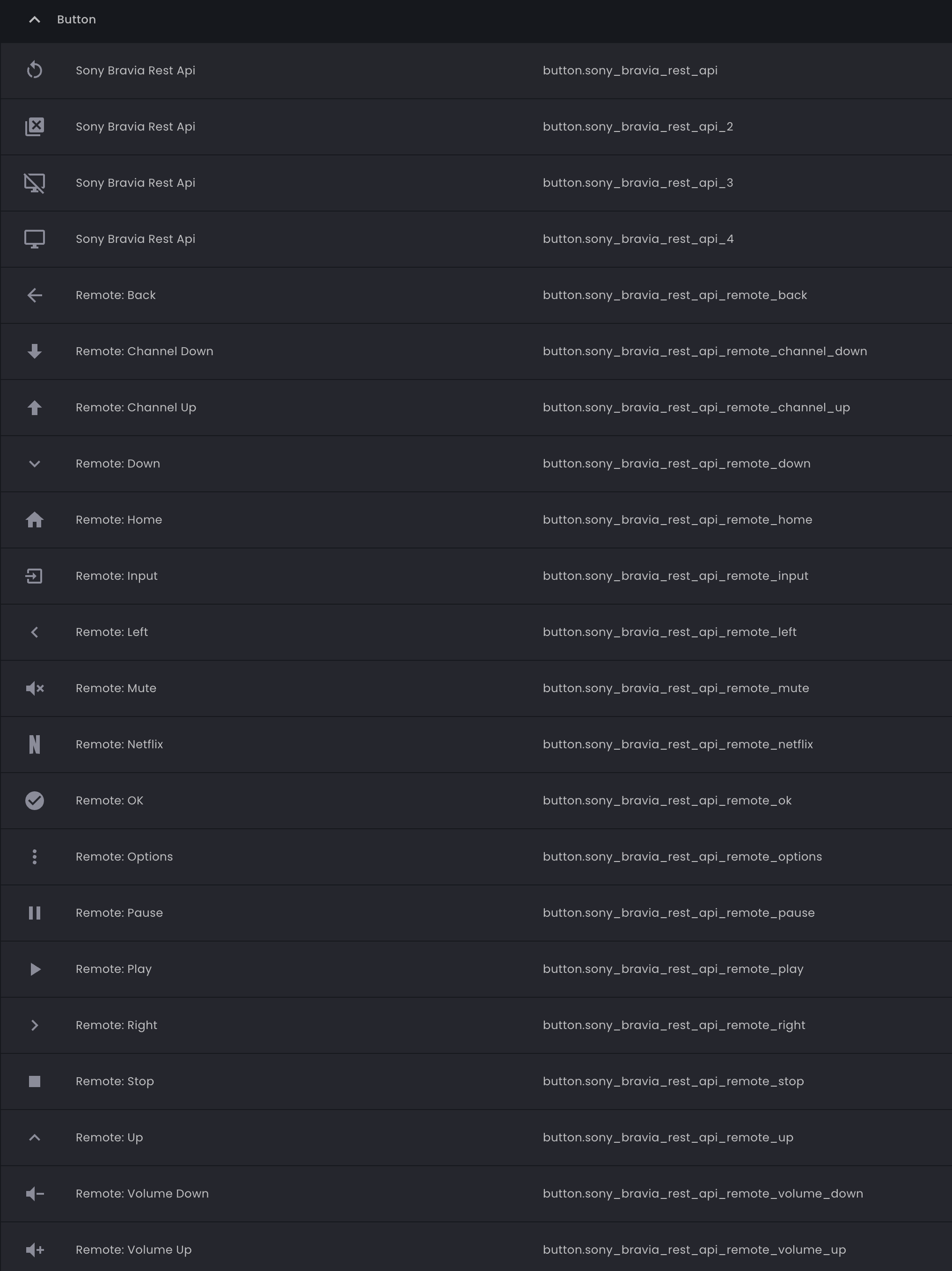

I'm just giving feedback, bugs are fixed, entity ids and names have automatically changed. Thanks! :rocket:
btw, the brand folder with icons is not in the component folder, which is why the icon is not visible in the integration dashboard. :eyes:
