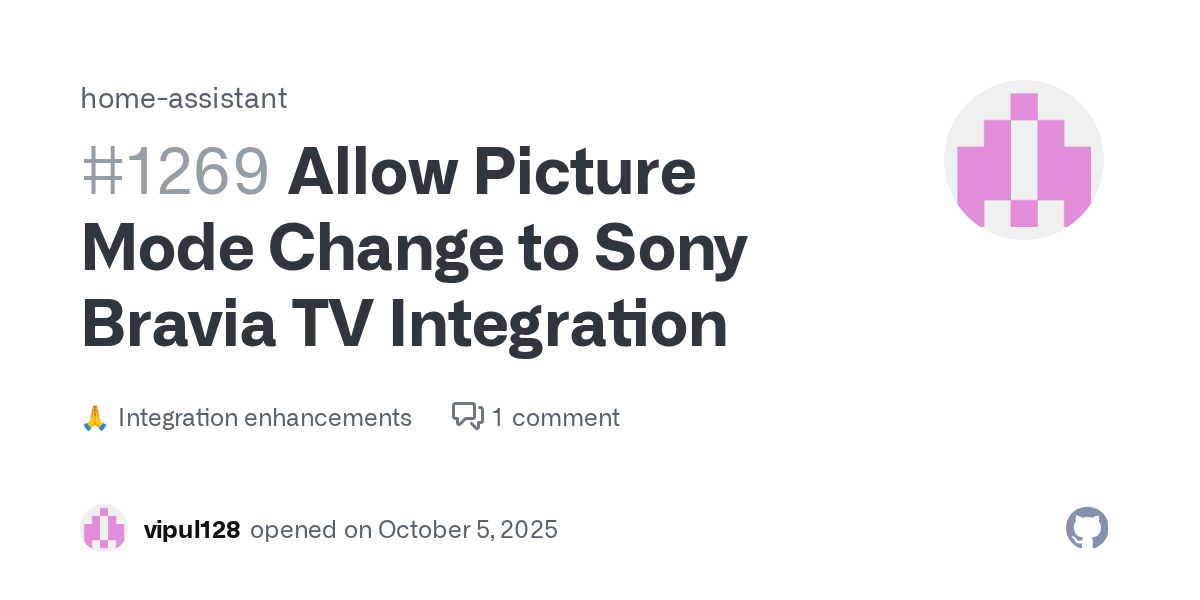

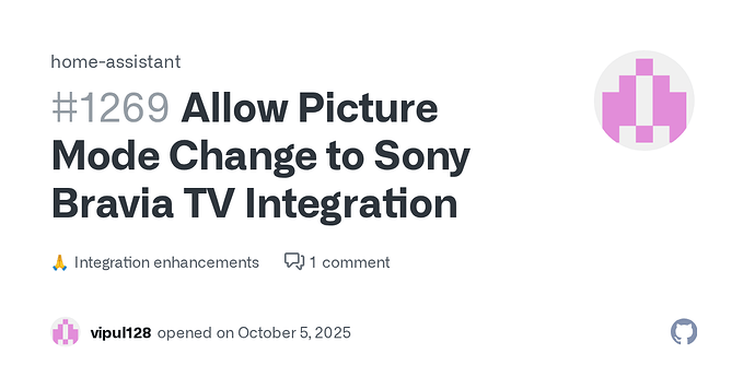

I did find a GitHub discussion recently started asking to add picture mode command to the Bravia TV integration.
