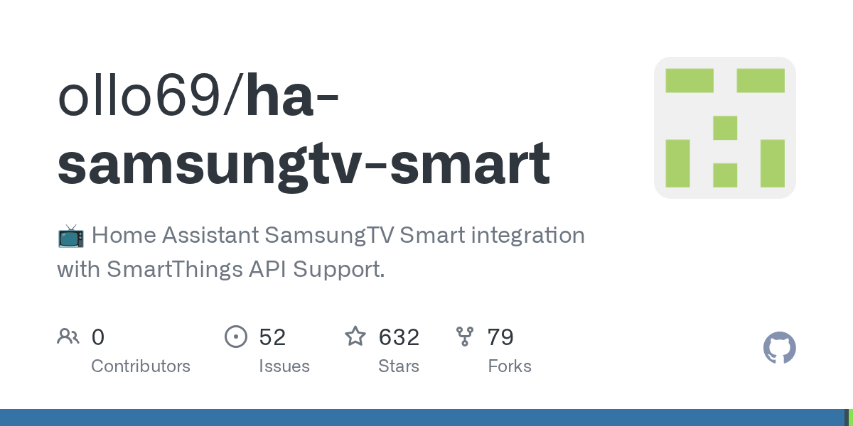

As stated in the linked thread, it is from a custom integration:
📺 Home Assistant SamsungTV Smart integration with SmartThings API Support.

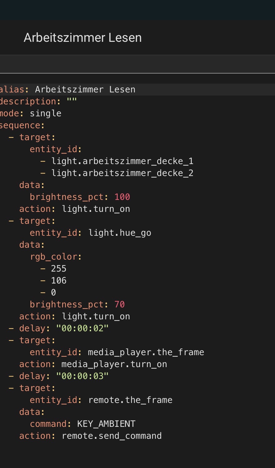

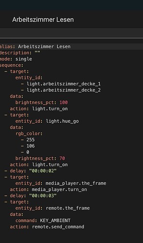

I asked Chat gpt and i got a working Skript for me.
It includes turning on 2 lights but maybe it will help you.
alias: Arbeitszimmer Lesen
description: “”
mode: single
sequence:
entity_id:
- light.arbeitszimmer_decke_1
- light.arbeitszimmer_decke_2
brightness_pct: 100
action: light.turn_on
entity_id: light.hue_go
rgb_color:
- 255
- 106
- 0
brightness_pct: 70
delay: “00:00:02”
entity_id: media_player.the_frame
action: media_player.turn_on
delay: “00:00:03”
entity_id: remote.the_frame
command: KEY_AMBIENT
action: remote.send_command
