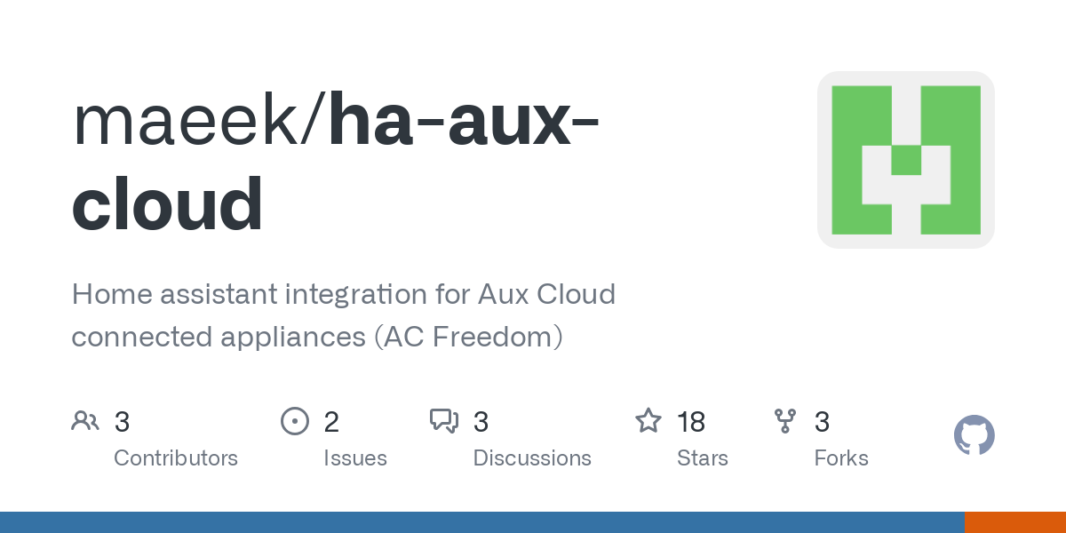

This integration works perfectly for me! GitHub - maeek/ha-aux-cloud: Home assistant integration for Aux Cloud connected appliances (AC Freedom)

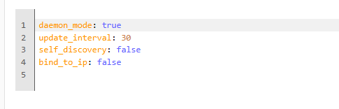

I was having the same issue over and over again, i noticed that if i reset my router it would fix the issue even without having to restart the addon, so i changed the update interval to 30, and it’s been 5 days without having the issue, i will continue to monitor, but so far looking promesing
daemon_mode: true
update_interval: 30
self_discovery: false
bind_to_ip: false
