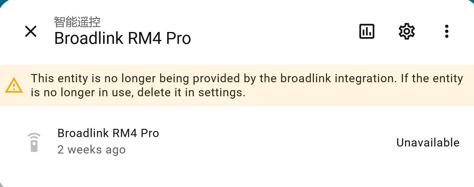

I have a Broadlink RM4 Pro in my home automation system and Home Assistant see it, but, for some reason it can not use it. See attached screen shot :
I do not understand why this is happening. The Broadlink device is working properly and controlling a 24vDC motor. Can anybody please tell me why I can not enable the Broadlink device?
What’s the entity ID? I believe generation of IDs changed recently to include the area name by default - may be something to do with that…
Broadlinks need to have a reserved IP address. Otherwise a power change or router reboot and the IP changes. Have you done this?
