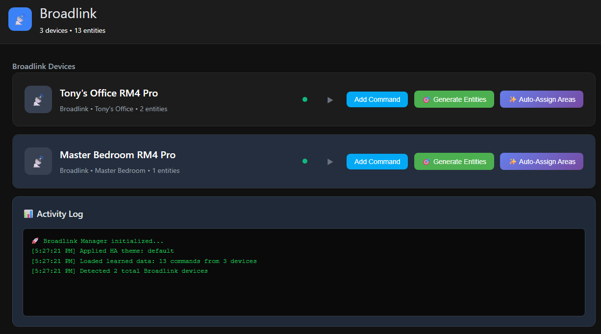

Broadlink Manager is a Home Assistant add-on that provides a modern, responsive web interface for managing your Broadlink devices. It solves the pain points of the default integration by making command learning and management intuitive and visual.
Key Features
:bullseye: Easy Command Learning - Point, click, learn. Real-time feedback shows when commands are captured

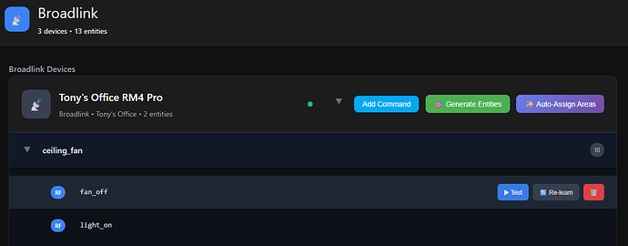

:file_folder: Smart Organization - Organize commands by area/room and device
:test_tube: Instant Testing - Test any learned command with a single click

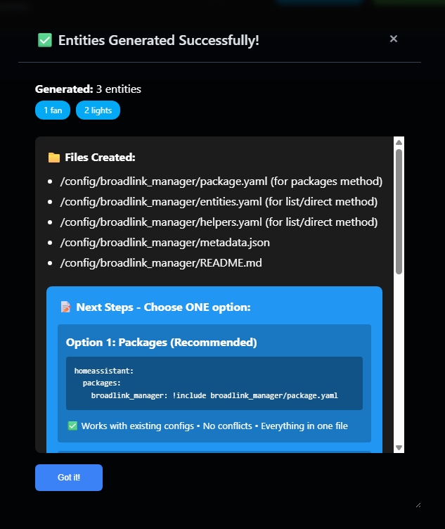

:robot: Auto Entity Generation - Automatically create Home Assistant entities from your learned commands

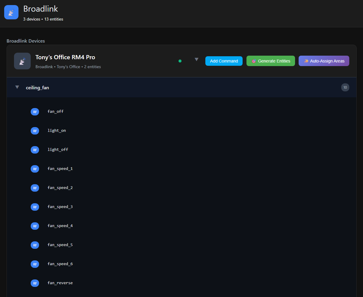

  • Supports lights, fans, switches, and media players
  • Uses smart naming detection (e.g., light_on, fan_speed_1)
  • Generates proper YAML with helper entities
    :electric_plug: No External Dependencies - Works entirely within Home Assistant
    :floppy_disk: Direct Storage Access - Reads from HA’s storage, so all existing commands are available immediately

For some reason I learnt all the commands for the 2 ceiling fans in my living room, however, it’s not creating the entities.

If you don’t mind opening a ticket here I’ll give it a look.
Also, please let me know if you are on the latest version and share the log output from the app if possible.
I’ll try to see why I didn’t get notification of your posts here and fix that.
Cheers
I have raised a bug with the logs attached. Yes I’m on whatever the latest version is

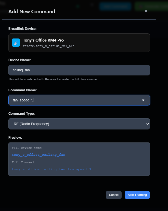

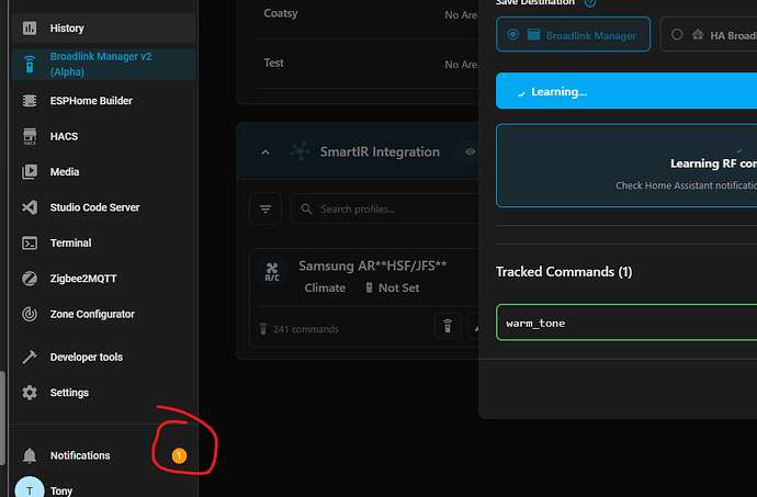

Hello you beautifull people :slight_smile: Love this little tool, Thanks.
I can get IR not working but RF wont work at all, I have tested that I can do it via the app, I just can’t not for the life of me get it to learn un HA :frowning: thanks legend :slight_smile: awesome job
Are you able to learn commands just using the broadlink add-on? The one where you have to go and manually call the service?
When learning RF it’s a two step process. When you click on learn be sure to keep an eye on the notifications. You’ll see a noticiation indicator show up
When you see that you press and hold the button to be learned for about 12 seconds. You’ll then see that “1” go away. Release the button at this point and you’ll see it come back again. At this point you just press and release and you should see the notification go away again.
Unfortunately learing RF is a two step process where the broadlink integration calls the sweep first and then the press/release.
I forgot to mention you can open the notifications tab to see the actual message/instruction coming from the integergration. My app, the manager just integrates with the integration to try and make things a bit easier to use.
