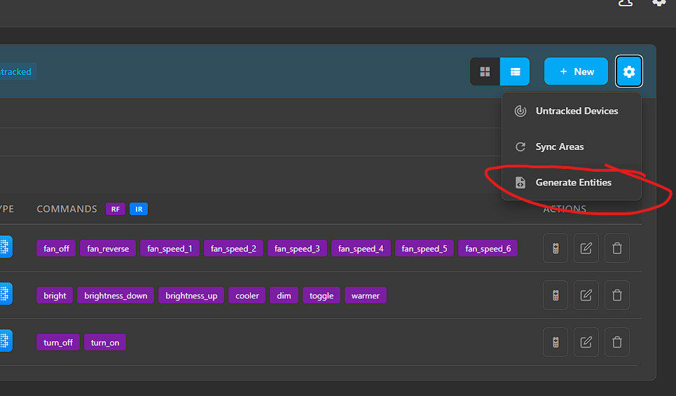

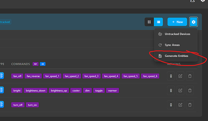

Sorry if this is a stupid question but did you generate entities?
