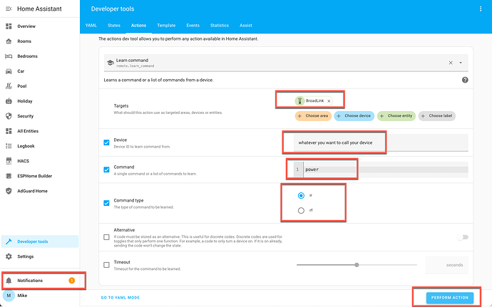

There may be more than one way to do it. I use the remote.learn_command service in the Developer Tools screen to learn IR codes. After learning, HA will keep the codes in the .storage hidden folder in a file named broadlink_remote_[xyz]_codes.
These codes will not be added to the Broadlink app. I bought my RM4s solely for use in HA, so I don’t use the app and I don’t care that the codes are not saved there.
Use these options:

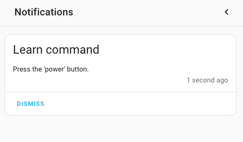

Then under Notifications you’ll get something like this:
Then you press your button on the remote so it can learn it.
