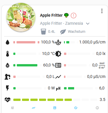

Hey there,

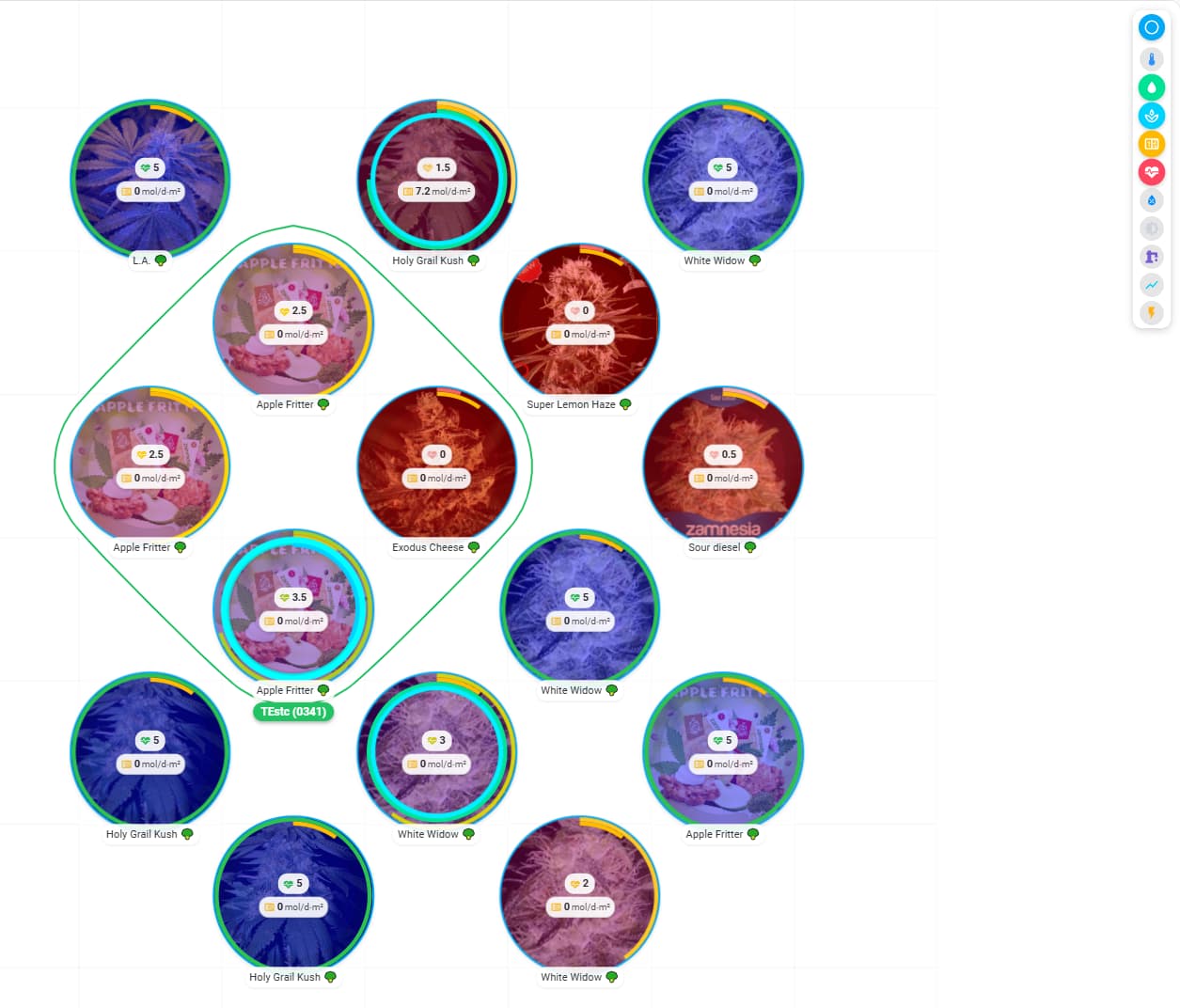

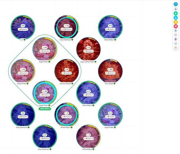

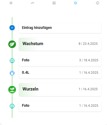

i have spent the last 6 months and forked olens famous plant integration to suit the needs of us cannabis lovers.
It enhances the plant integration with:
  • various sensors
  • helpers
  • services
  • automation trigger
  • profile pulling from seedfinder
  • a picture gallery
  • import/export plant profiles/pictures/sensor data
  • and some customizable cards to easily interact with your plants on the frontend
the project is still in an early stage with more sensors and stuff to come but i thought it is time to share and get some feedback.

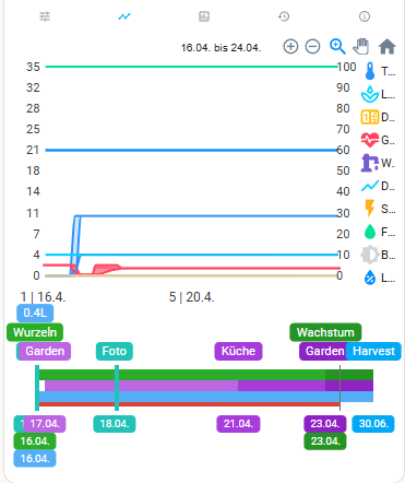

This looks great. I install and test it a bit. How does the Water consumption feed works. Is this like I can add a value if the pumpe provides water to it?
Is there documentation about all this sensors?
thanks man
it calculates the water sensor drop and multiplies it with pot size and water holding capacity.
Assuming you have a pot with 4L soil. Soil normaly has a water holding capacity of 50 or 55%.
So the pot can hold 2L of water total. When the sensor drops from 100% to 50% you’ve lost 1L of water.
I had no time for a documentation yet. Still gathering ideas.
At the moment i am planning a crop stearing feature where you can dynamically create grow plans in an kind of line graph card (or advance the current line graph) that translates to blueprints which can than be assigned to plants or cycles. Those adjust the thresholds of the sensors along the grow, which than could control fans, lights and water pumps in your individual system. Like a “8 weeks low fertilizer” plan or “10 weeks with sunrise” stuff like that.

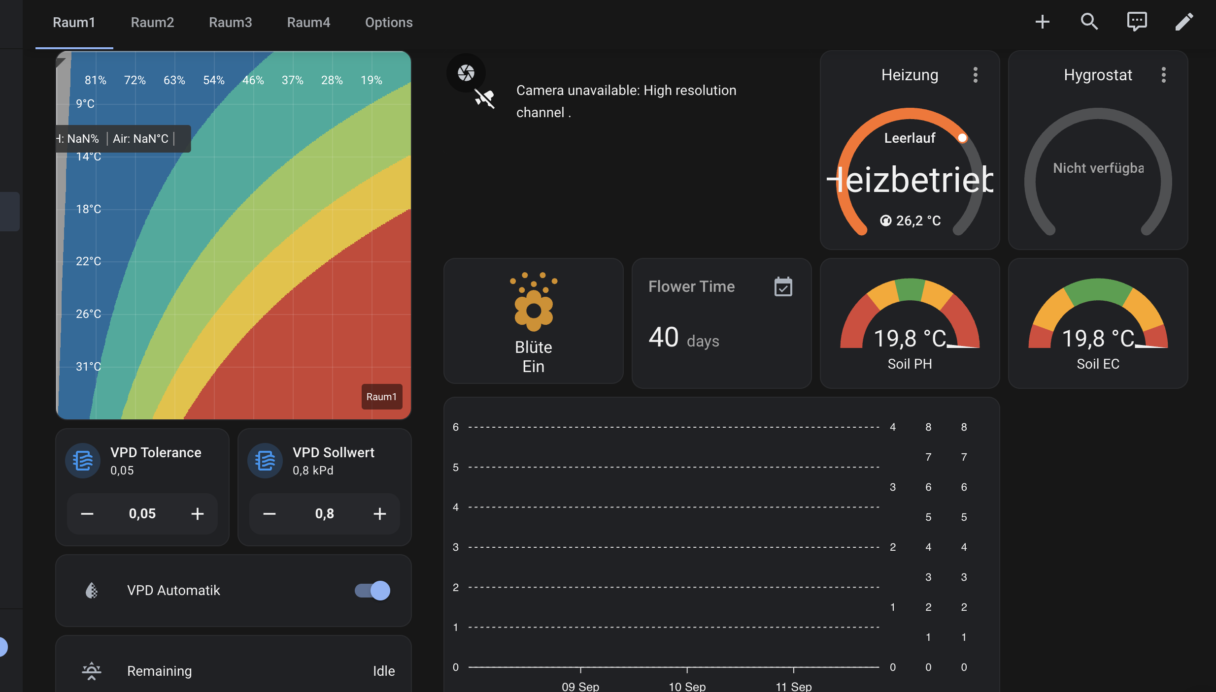

i had my HA grow setup somewhat like this lately before moving, but needs an overhaul anyway. so perfect timing :smiley:
btw i even played a bit with camera-screenshots twice a day + chatgpt to get a notification on my phone if something looks strange :slight_smile:

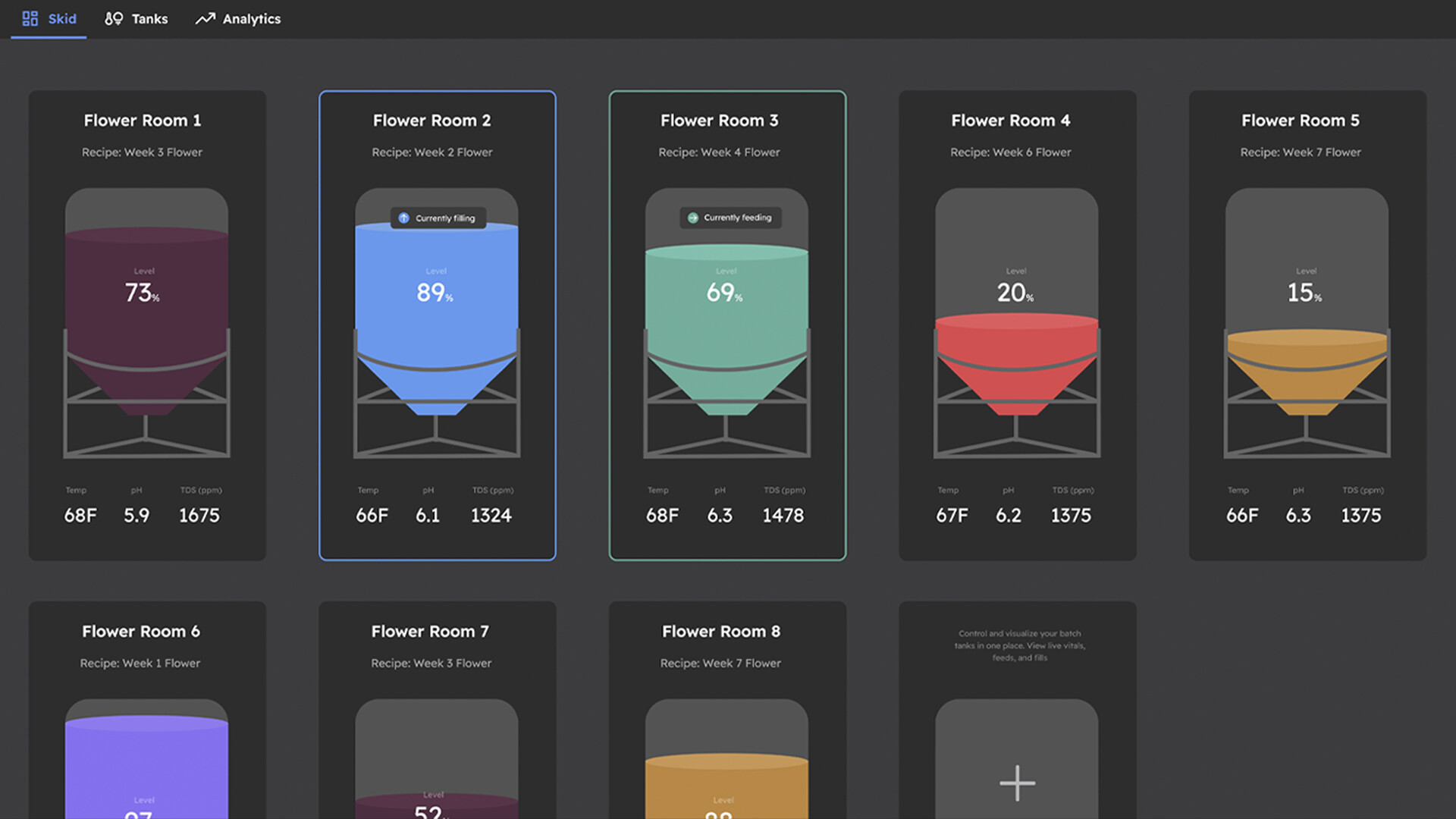

for having some visuals like growlink has for tanks
i used this

I know the fluid level background card. Its a bit bold for my liking.

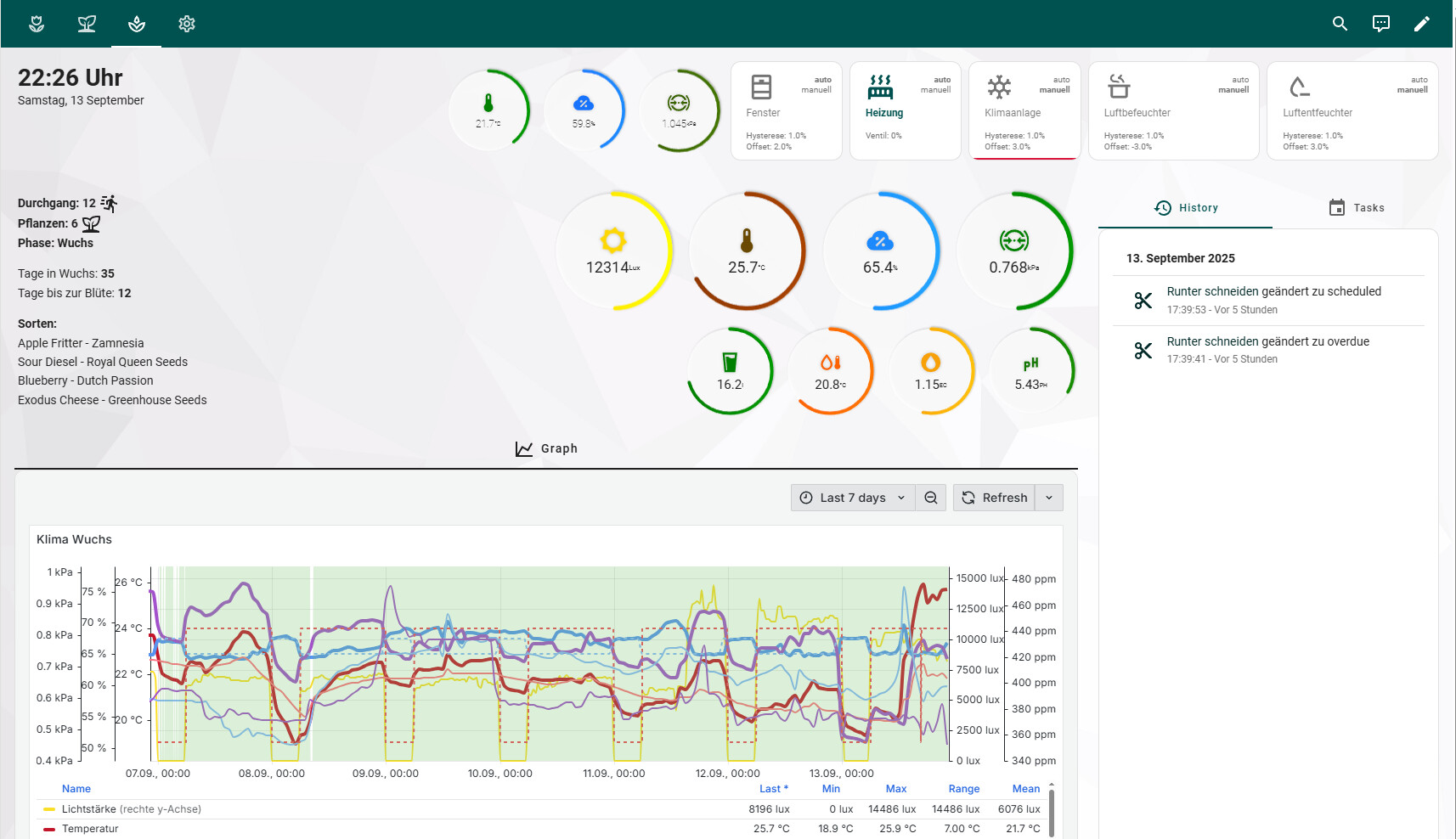

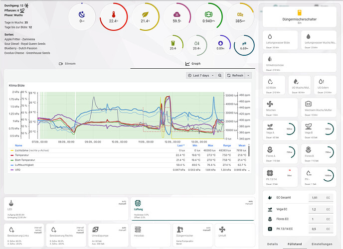

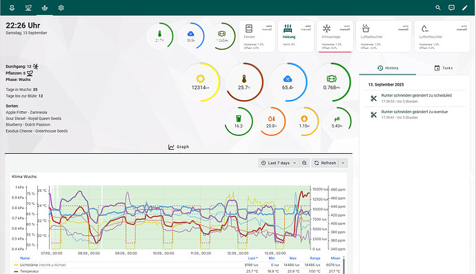

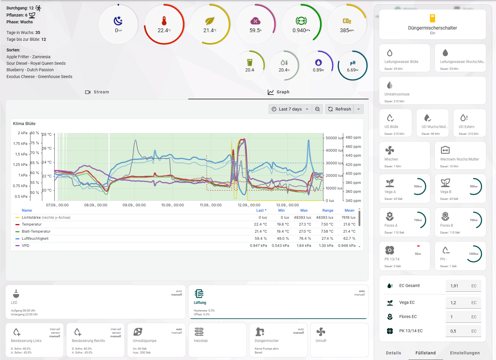

My setup looks like this:
its still not finished, but i can see nearly the full picture
It mainly consists of custom button cards, a grafana graph, camera streams, a history and a forked activity manager and card

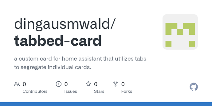

in forked tabbed cards

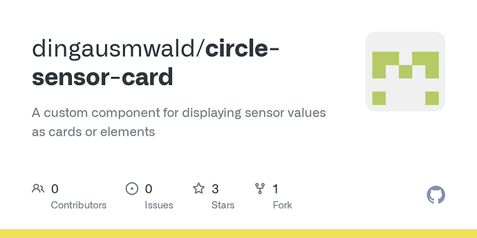

circle sensor cards i forked

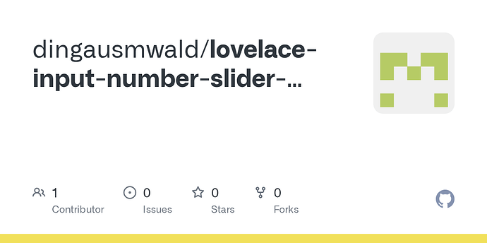

a slim slider combo card i created
and this neat bubble card that opens as menue for every button on the right side.
There i have the levels of my fertilizer in the custom button cards (for my dosing pumps) in circle cards.
Since this is all in a grid layout, it folds nicely for tablet and mobile phones.
The plant suite will take place in the middle tabbed card with the stream and graph, a mix of the position and list card i think. The actual flower card will open in the bubble card popup like a more info for a plant.
