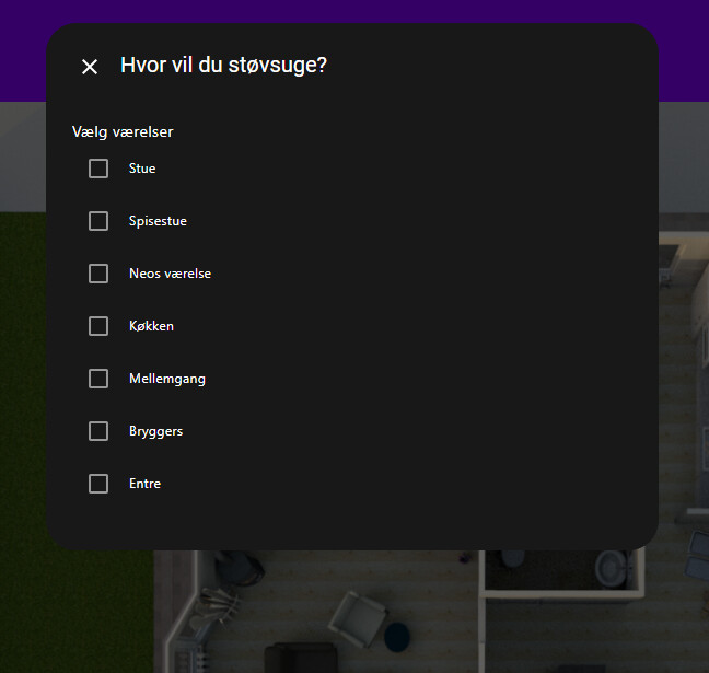

I am been using browser_mod pop up for vacuum control on a tablet showing floorplan. It has been working flawlessly but all of the sudden the “start-button” is no longer showing at the bottom of the pop-up window. Any idea how to fix this?

Can you try with standard theme? It may be the buttons are there but you can’t see them?

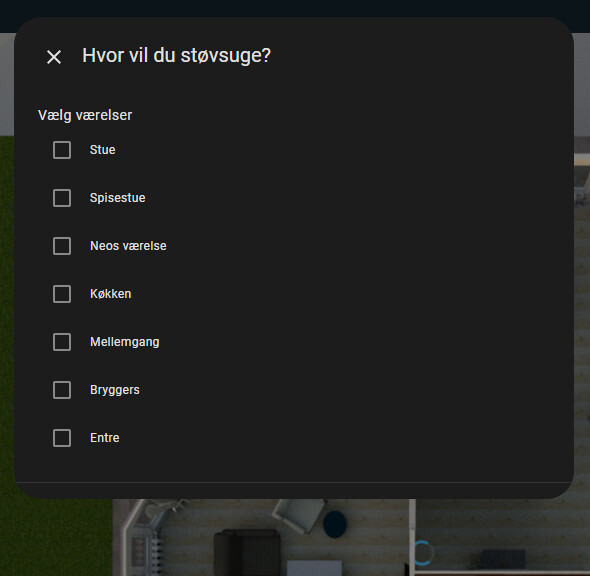

Great suggestion. I already tried changing the theme and there is no luck unfortunately. HEre is the pop-up in standard theme:
Looks like something is cutting off the bottom. Is this just the tablet? Does it work OK on desktop?

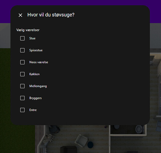

Screenshot is from my computer. Problem is accuring both on the tablet and on the PC
I tested your config and I get the ‘Start’ button fine. Are you sure you don’t have a custom element that is adjusting theming or dialogs, even perhaps related to more-info?
I think you might be on to something! But im not sure what the problem is. Here is the complete code for the vacuum pop-up:

Just to double check I have set my popup from a picture element like in your code, but I can’t reproduce. The fact that you have the border above where the buttons should be shows that they are likely there in the HTML but something is causing them to not show, which has me still thinking there is some theme element happening. As it is happening on a desktop, take a look at developer console and see what is included in the area where the buttons should show.
Themeing can stay around sometimes, so maybe try refreshing caches.
As it started happening recently, have a think about what you changed and that may help isolated.
