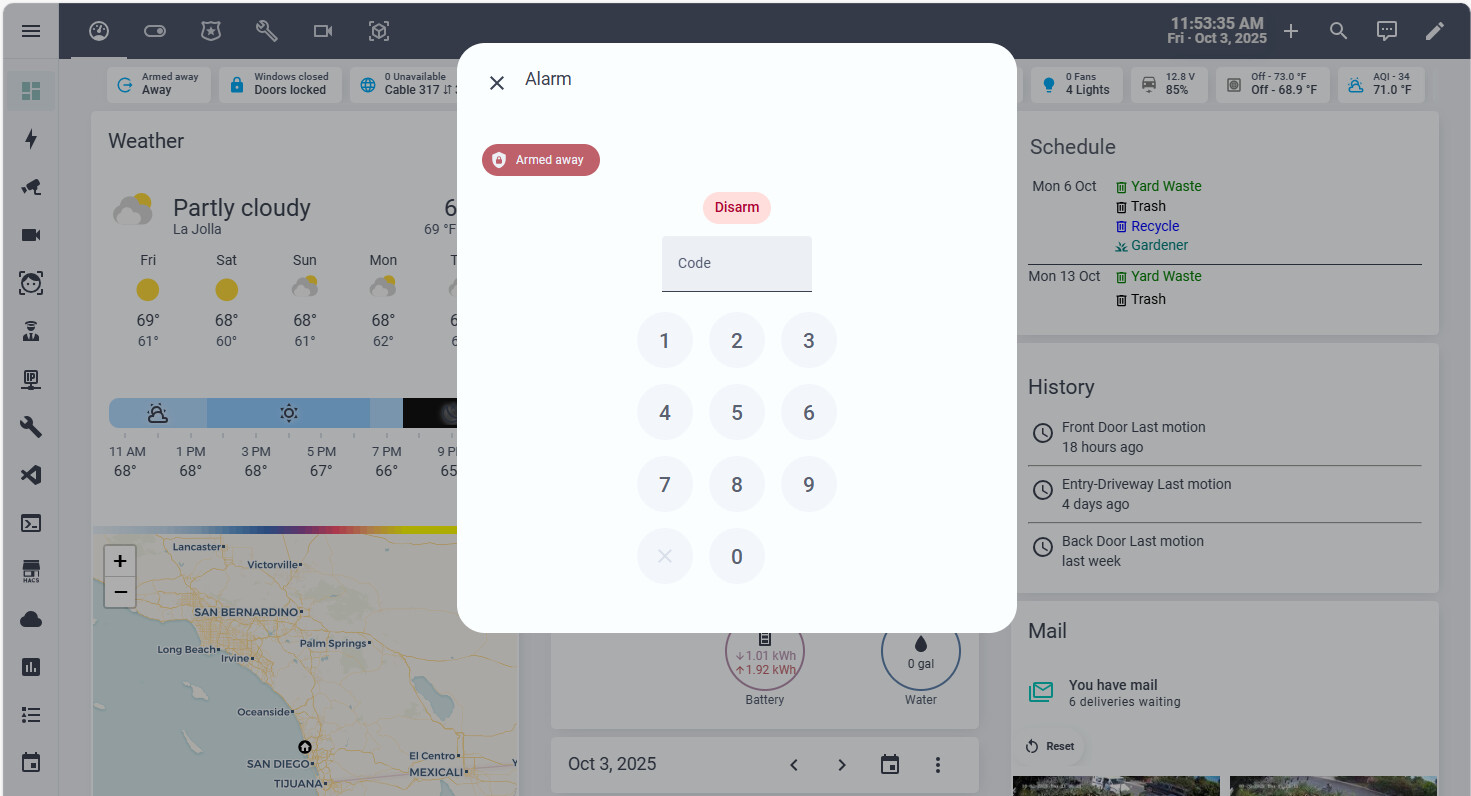

After the most recent updates, Browser_mod behaves improperly on iOS Home Assistant Companion App.

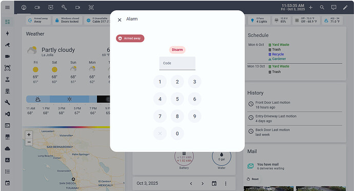

On a browser (Edge on Windows 11), Browser_mod continues to behave properly without modification of the YAML:

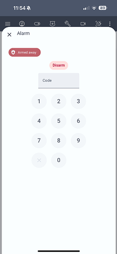

However, on the iOS Companion App, the popup card is no longer ā€œclassicā€ sized (even after updating the YAML from size: classic to initial_style: classic). Additionally, I could previously close the popup by clicking outside the popup. Now I have to use the ā€œĆ—ā€ to close the popup. It seems that the iOS Companion App (but not the browser) treats the popup as a webpage or tab and that to close the popup without clicking on Ɨ, one needs to navigate away:
Here is the YAML for the script; what do I need to update?
