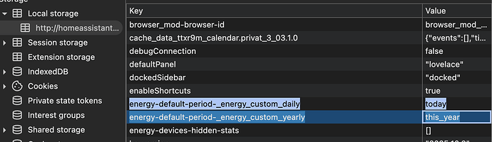

I try to somehow reset the displayed timespan for multiple energy date pickers (energy-date-selection) on a custom energy dashboard.
I have a date dicker and few energy cards (see: Energy cards - Home Assistant) normally displaying hourly values of the current day.
below, I have a second date picker which is normally set to the current year and a few of the cards showing monthly values of the current year.
The date pickers and the corresponding energy cards have the same ā€˜collection_key’ set as described here to stay in sync:
Now sometimes, I change the time range on the daily charts to weely or montly.
But I would like to reset them after a specific time, so I see the dashboard in its initial value when opening it later.
The energy date pickers save their state in the current browser in the localStorage.
And that’s what I want to reset.
I tried using the Browser_mod → Default action → Global like this:
action: browser_mod.sequence
sequence:
  - action: browser_mod.javascript
      code: |
        localStorage.setItem('energy-default-period-_energy_custom_daily', 'today');
        localStorage.setItem('energy-default-period-_energy_custom_yearly', 'this_year');
But this isn’t working sadly.
I was afraid, that it wouldn’t apply fast enough, so I see the charts / picker flickering and updating two times. But in fact nothing happens at all.
Any idea what might be wrong?
It does not look like it is that simple. The energy date picker both sets the localStorage item but also the range of the date selector, which updates the date range of the queried data to the energy data collection. The localStorage item only affects on first load of the energy data collection. When energy data collection returns data, this updates the range of the energy date picker. The energy data collection is untied form a dashboard hence why the dashboard and energy date selector remembers the range.
I can’t see any easy way to achieve what you want.
Thank you for your hints. :slight_smile:
I’ve already noticed that the energy date picker isn’t using these localStorage keys while on the page.
But I wasn’t aware that this selection is untied from the current dashboard, so leaving and reentering the dashboard in the same tab / browser-session will also not trigger a reload.
So this solution got quite a bit larger than I hoped for, but it’s working. :partying_face:
It is important to use specific energy collection keys for all the pickers you want to control this way and not use the default.
That way this solution is working independently from other date pickers on your dashboards.
It will call itself recursively every 10 seconds and check if you just left the dashboard with the date pickers and reset them in this case.
Otherwise it will check if you’re currently on the dashboard with the date pickers and will then reset the date pickers only if there are no touch or mouse movements in the last 5 minutes.

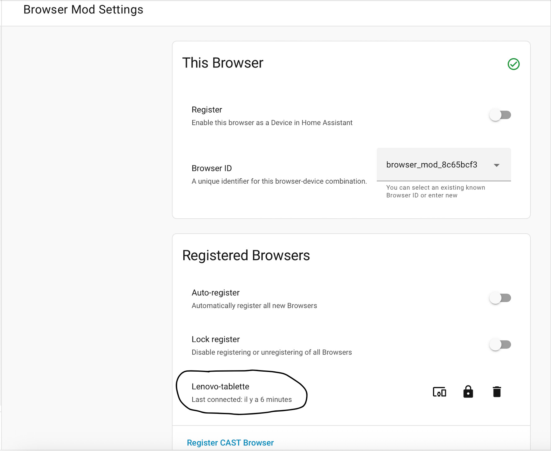

Hello, I am using browser_mod.popup to display my camera stream using this code, works perfectly until browser_mod updates, after such update the popup doesn’t popup anymore, and I always need to figure out what happens / how to repair.
Here is my code :
  - data:
      title: CamƩra ExtƩrieuresxxx
      dismissable: false
      content:
        camera_view: live
        type: picture-glance
        entities: []
        camera_image: camera.dahua_rue
        aspect_ratio: "1"
      timeout: 300000
      browser_id:
        - Lenovo-tablette
      right_button: Fermer
    action: browser_mod.popup
… the ā€œbrowser_idā€ is I think what causes the issue … it is my tablet ā€œLenovo-tabletteā€, and it is appearing to be ok in the Browser Mod page :
… the browser_mod updated couple of days ago, and again, my popup is not working anymore. Any idea what I need to look at on priority ? What I need to do ?
Many thanks !!
If your Browser ID changes you can just change it back using the dropdown, which will update the Browser ID as well as toggle register.
Just updating Browser Mod itself should not change any Browser IDs. However whenever you clear cache of the device you will lose Browser ID as it is stored in localStorage of the Browser which is cleared when you clear caches. When you update Browser Mod you don’t need to clear cache, just click Reload on any popup that notifies of the client code being behind server. If you are clearning caches for other reasons, then you will always lose Browser ID and have to reset.
Browser ID didn’t change … still the same ā€œLenovo-tabletteā€ …
The update definitely breaks the connection between the tablet and the HA … I was able to restore the connection by restarting the HA.
Many Thanks !
