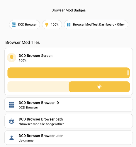

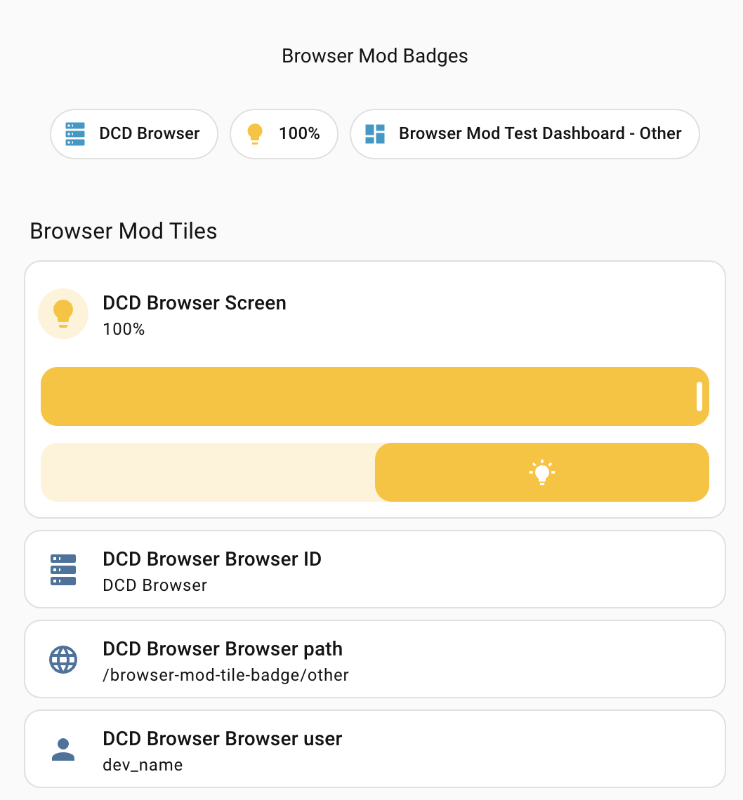

:mega: Browser Mod 2.7.0 Released :mega:
v2.7.0 release notes.
Noteworthy new feature is Browser Mod Tile and Badge. Readme more about these HERE.
