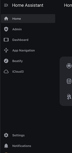

i observed the since the last ā€œupdatesā€ that the browser_mod is not loaded correctly from time to time. So i need to refresh the dashboard manually to load my config correctly. I see it really fast because i made some changes on the sidebar order.
Anyone with the same issue? Or anyone idea for a fix?

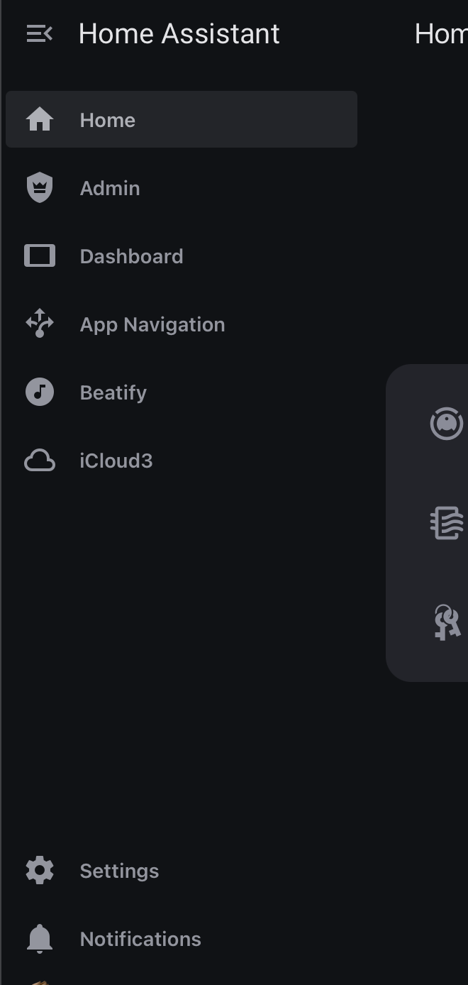

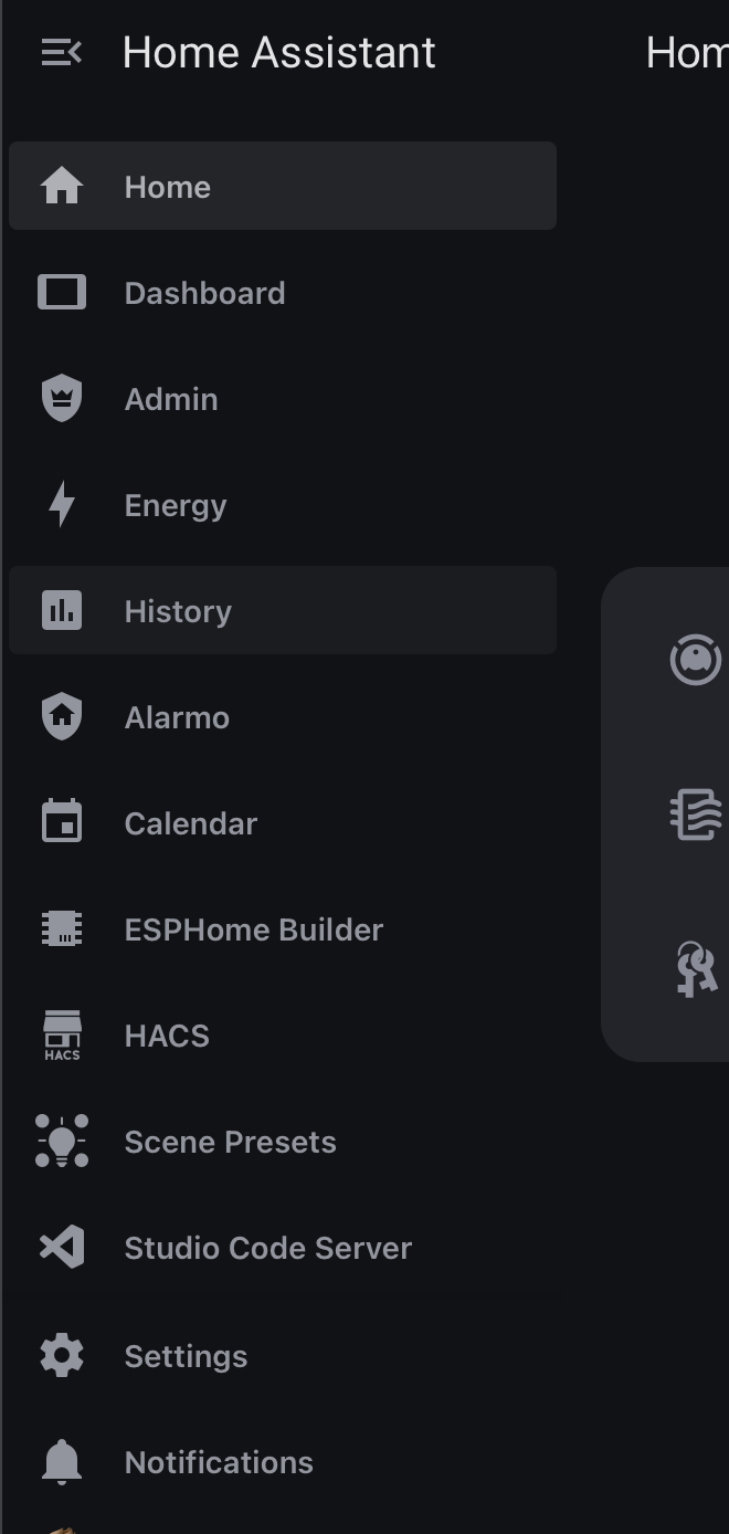

yes its hard to explain. I don“t think this is an issue of slowness. This happens on multiple devices and multiple browsers but only sometimes. When it exactly started i don“t knowl

@Mar1us I am thinking this may be due to perhaps having localStorge cleared in your Browsers. Currently, once localStorage is set for sidebar panels by Browser Mod, no refresh is attempted, so you have to do a manual refresh.
2.7.4-beta.1 is now available that will refresh the sidebar when settings change, including when setting localStorage on page load.
if your issue is what I suspect, then 2.7.4-beta.1 should help.
i installed the beta version and will test this now :+1:
I have tested it for two days now and have not encountered this issue once. Very rarely, I see the entire sidebar become visible again, but it refreshes ā€œinstantlyā€ and the customizations are loaded.
