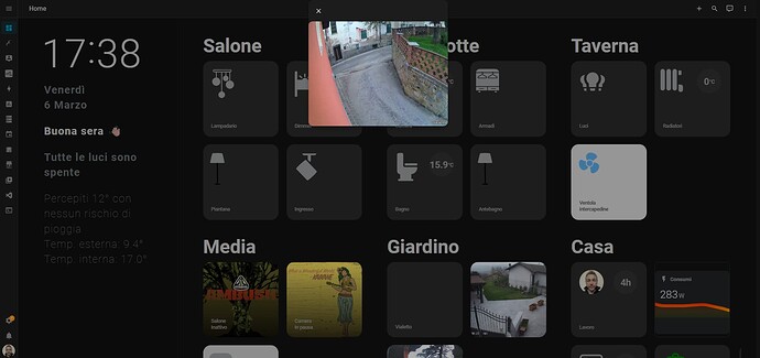

Hello, I’m here again to ask for support, I use browser mod for my popups more or less with the same style. Yesterday, after last updates (core and browser-mod) my popups got smaller (biggest problem!) and with an header, this is an example with my camera:
It seems my code needs a restyle after the update:
  tap_action:
    action: fire-dom-event
    browser_mod:
      service: browser_mod.popup
      initial_style: wide
        hide_header: true
        card_mod:
          style: |
            ha-wa-dialog {
              --mdc-dialog-min-width: auto !important;
              --mdc-dialog-max-width: 70vw !important;
              --mdc-dialog-min-height: auto !important;
              --mdc-dialog-max-height: 90vh !important;
              padding: 0 !important;
              margin: 0 !important;
            .content {
              width: 100% !important;
              height: 100% !important;
            ha-card {
              box-shadow: none !important;
              border: none !important;
            @media (max-width: 768px) {
              ha-dialog {
                --mdc-dialog-min-width: 95vw !important;
        content:
          type: "custom:webrtc-camera"
          entity: camera.vialetto
Could you please guide me in the right direction, possibly in my code there was already something not correct, but, you know, ā€œdon’t touch something until it’s workingā€ :smiley:
I’ve seen in the issue list on github that you use uix (i ignored this until now), do I have to use it to size my popups now?
Thank you in advance, whatever help is appreciated!
The header issue is fixed eith Version 2.8.2.
ha-wa-dialog no longer exists, change to ha-dialog. However, the mdc vars would have never worked with the wa dialog. To style width use —popup-width.

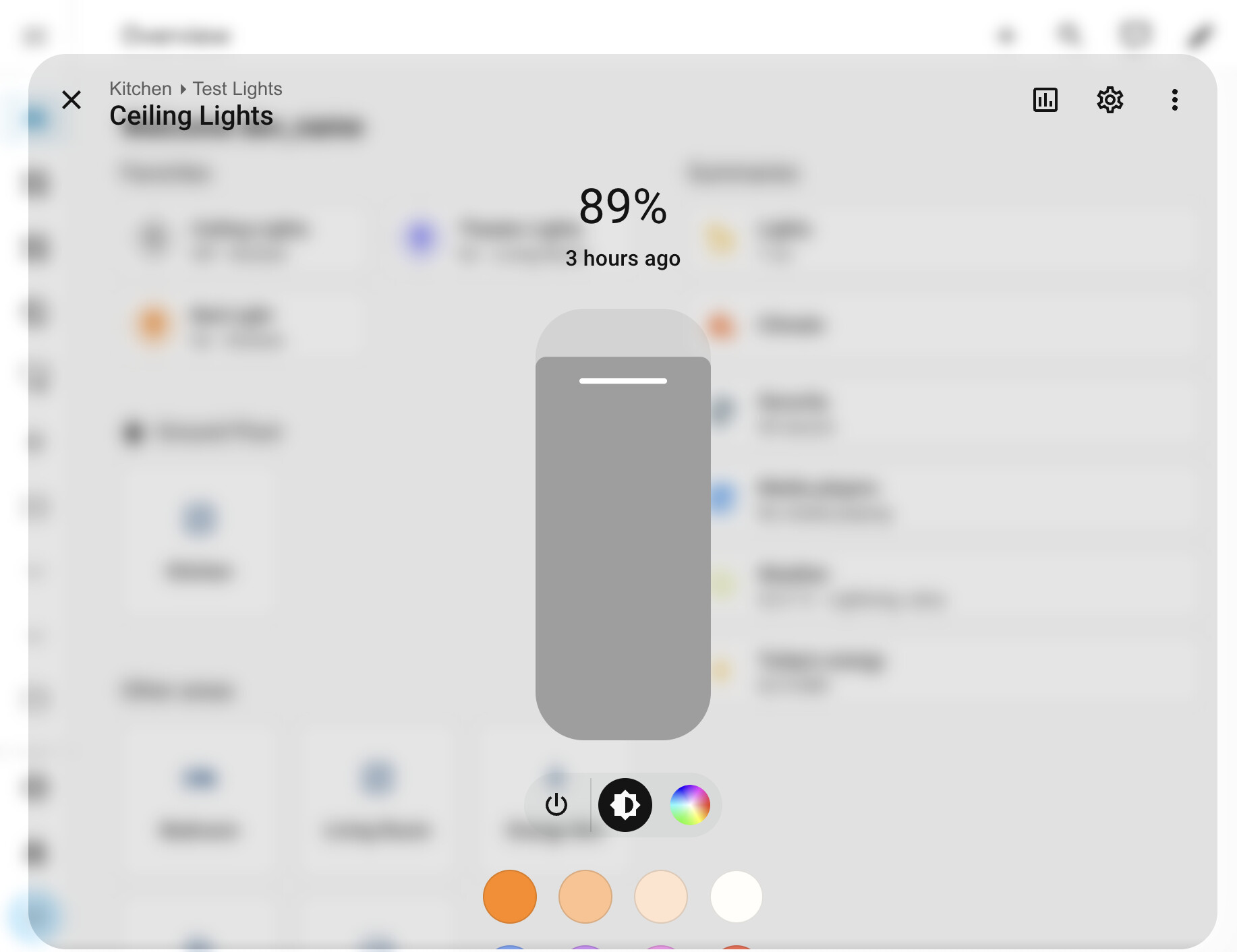

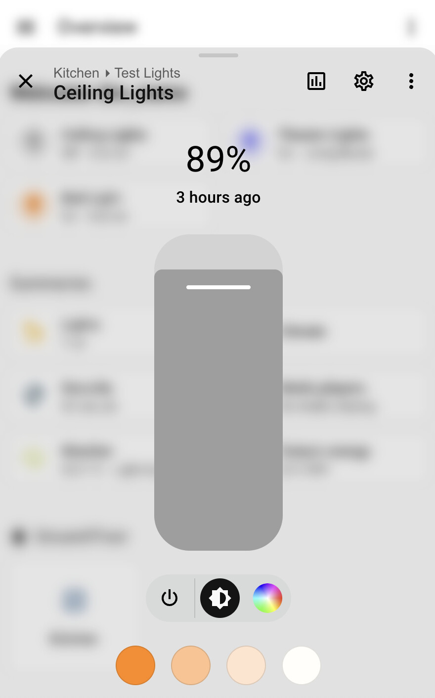

Also, ha-adaptive-dialog is now the first elemenet, with either ha-dialog or ha-bottom-sheet as the next element in shadow root. I expect blur is working as ha-dialog-scrim-backdrop-filter is set in your theme. As it stands none of the styling will be working for more-info.
So to guide you here, and I will probably take as basis for a Uix guide, below is a simple theme file, noting that there is no shadow root needed, so using uix-more-info rather than uix-more-info-yaml.
UIX Test:
  uix-theme: UIX Test
  uix-more-info: |
    /* Works for both ha-dialog and ha-bottom-sheet */
    /* For ha-dialog specific themeing see https://github.com/home-assistant/frontend/blob/44d727763c16060de776d4acf01d7152213330af/src/components/ha-dialog.ts#L53 */
    /* For ha-bottom-sheet specific themeing see https://github.com/home-assistant/frontend/blob/44d727763c16060de776d4acf01d7152213330af/src/components/ha-bottom-sheet.ts#L34 */
    :host {
      --ha-dialog-scrim-backdrop-filter: blur(5px);
      --ha-dialog-surface-background: rgba(0,0,0,0.1);
      --ha-dialog-surface-backdrop-filter: blur(4px);
      --dialog-box-shadow: 0em 0em 2em white;
      --ha-dialog-border-radius: 2em;
      /* more-info uses attributes for size but these cannot be set by Uix so just override medium size */
      --ha-dialog-width-md: 95vw;
Further note that as far as what ha-adaptive-dialog styles, it only sets border radius and padding of of bottom sheet, so these would be only vars that you may need to have !important on.
Screenshots
Dialog
Bottom Sheet
