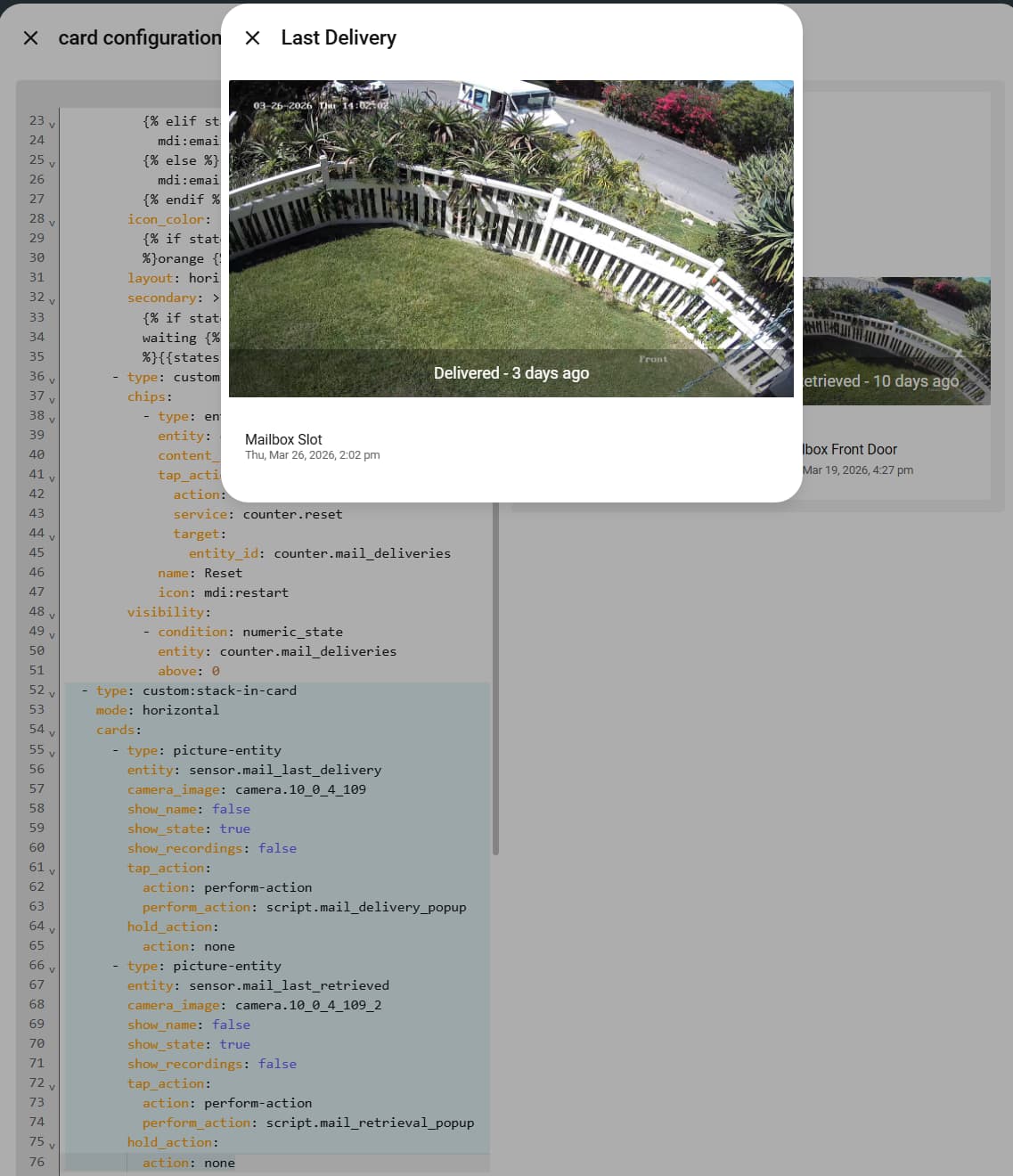

Quick note that Brower Mod 2.10.1-beta.3 has a few fixes for Home Assistant 2026.4.0b0 due to timings of dialogs.
  1. Frontend settings popups will not appear first clic, but do second.
  2. Popup buttons will not always be spaced evenly and may be all on right (which is Home Assistant default).
2.10.1 will not perform a script action from within a popup window itself, whereas prior versions would. For example, when a thumbnail is tapped, this card will successfully call a script to open a larger popup window showing mail delivery, as it has always done:
  - type: custom:stack-in-card
    mode: horizontal
    cards:
      - type: picture-entity
        entity: sensor.mail_last_delivery
        camera_image: camera.10_0_4_109
        show_name: false
        show_state: true
        show_recordings: false
        tap_action:
          action: perform-action
          perform_action: script.mail_delivery_popup
        hold_action:
          action: none
        entity: sensor.mail_last_retrieved
        camera_image: camera.10_0_4_109_2
        show_name: false
        show_state: true
        tap_action:
          perform_action: script.mail_retrieval_popup
        hold_action:
          action: none
The prior behavior was that tapping within the popup picture-entity card would call a corresponding script showing mail collection, but no longer does so, instead simply closing the popup window:
alias: Mail Delivery Popup
sequence:
  - data:
      content:
        mode: vertical
        cards:
            mode: vertical
            card_mod:
              style: |
                ha-card {
                  background: none;
                  box-shadow: none;
            cards:
                show_name: false
                show_state: true
                tap_action:
                  target: {}
                hold_action:
                  action: none
              - type: custom:multiple-logbook-card
                desc: true
                entities:
                  - entity: binary_sensor.mailbox_slot_door
                    hidden_state:
                      - unavailable
                      - "off"
                title: " "
                show:
                  state: false
                  duration: false
                  start_date: true
                  end_date: false
                  icon: false
                  separator: false
                history: 30
                max_items: 10
                collapse: 5
                no_event: " "
                hidden_state:
                  - unavailable
                  - "off"
                date_format: ddd, MMM D, YYYY, h:mm a
                card_mod:
                  style: |
                    ha-card {
                      background: none;
                      box-shadow: none;
                visibility:
                  - condition: numeric_state
                    entity: sensor.mail_last_delivery_absolute_days
                    below: 11
      title: Last Delivery
    action: browser_mod.popup
mode: single
icon: mdi:email-outline
HA Core 2026.3.4
HA Operating System 17.1
HA Supervisor 2026.03.2
Thanks for any assistance.
Recent changes in dialogs in Home Assistant Frontend has meant there are different timings which mean that code that is resusing the standard popup tag (none) may have issues as code to show popup will close existing popup of same tag (none) if open, but the flag for open and whether the close sequence has completed is where the timing can be an issue and the new popup opened is then closed.
If you can make a real simple config with cards and script that would help me replicate the issue faster and update to cater for the issue.
In the meantime, an easy workaround is to give each popup its own tag.
Thanks for the immediate response. I’m not sure what you mean by ā€œgive each popup its own tag.ā€ I have the popups embedded in scripts, each with unique names. (The issue seems unique to v2.10.1, not resulting from changes to HA, as I can revert to v2.10.0 and the new issue goes away.)
2.10.1 has fixes relating to popups and reuse of same tag, which has caused your issue. You may wait until I have time to review or try the tag workaround.
The workaround is to give different popups a tag tag: my-tag. See Multiple Popups
Thanks, again, appreciate it. I’ll give the tags a try.
