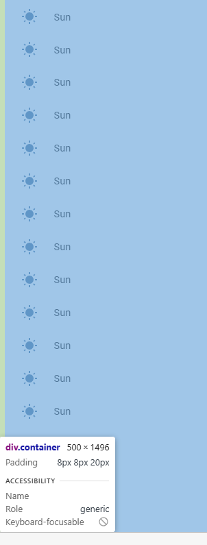

On every browser and every device. Windows and Apple. Full heigh. Only below 500px is is moving to fullscreen with same height but overflow and scrollbars
Can you point me to the dom nodes where (in your working case) the heigh and overflow or scroll behavior is set, so we can compare?

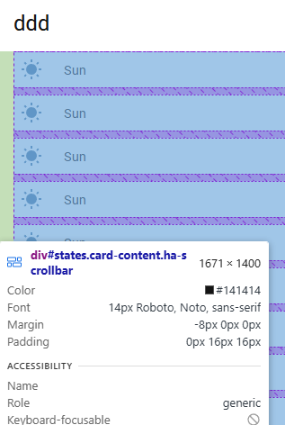

Got it. From which cache ever this was still applied from my theme if I used the standard theme, it is related to the centering
Here I used your example and suggestions form the docs to set the margin top auto, but this is leading to the behavior here.
OK. So that styling does not work for newer dialogs with extended content.
Will check what may work. With the changes in Home Assistant there may be no option.
There is also --popup-max-height that you can define.
Default applied by Browser Mod is --popup-max-height: calc(100svh - var(--dialog-surface-margin-top) - var(--ha-space-2) - var(--safe-area-inset-bottom, 0px)) which will break when using --dialog-surface-margin-top: auto so this could be a bug to fix but not sure how given that if --dialog-surface-margin-top is a size then it needs to part of the default max-height calculation and not sure CSS can deal with a var being auto in a calc.
Anyhow, you have a workaround, that is, to specify a desired --popup-max-height if you set --dialog-surface-margin-top: auto. Saying that, if you know your dialog will be large then you would not set -dialog-surface-margin-top: auto. If you believe this needs further addressing please raise an issue on GitHub. Thank you.

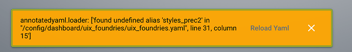

and the Toast seems to show alright
However, if I click that button before having fixed the yaml, I expect the toast to popup once more, and in this case, it disappears.

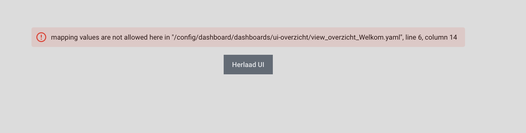

This won’t work as once the dashboard is in error it does not have lovelace root for the lovelace_reload function to work. If the dashboard is not in error then lovelace_reload works (e.g. I tested having working dashbaord, introduce error in my dashboard, simulate your toast with lovelace_reload as action, then it works to refreh and get error showing).
So as you suggest, you will need to find the event/function to cause a reload in this case.

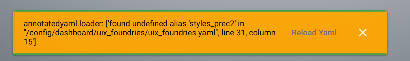

if I leave the toast (which remains forever whiteout clicking the X) and Refresh (menubar Refresh item) the toast clears, (while the pers notification adds) .
maybe one of the parameters causes this behavior, but I would have expected it to always produce the toast, even if it already exists
