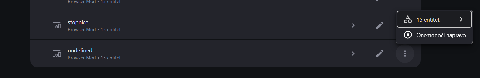

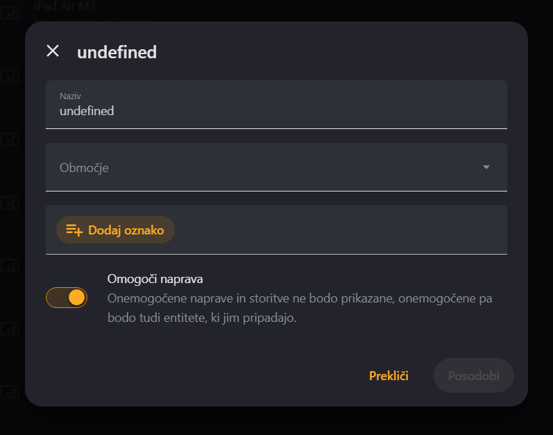

It seems that i can't find where to delete registered device now... all i can do is disable it, but i'd like to remove it. It's not in old browser mod setting anymore, also not in new under devices...? It must be hidden somewhere (from me...)
you delete a device from the Browser Mod integration config panel. Same panel as before when it was part of Frontend, just now in integration.
If you have orphaned Browser Mod devices they can be cleaned up with browser_mod.deregister_browser. Put your known Browsers in an area and then use the service with area_exclude_id.
Hm... that's what i'm searching... it used to be an icon to remove entry, but not anymore... ?
Not for Browser Mod as it manages as one integration entity. Use the Cog to get to the Browser Mod integration panel (what used yo be on the Frontend Browser panel for admins).
ahhhhhh.... stupid me... :nauseated_face: the only thing i didn't click....
Thanks a lot!
It’s the recent change with 3.0.0
Yeah, i did catch that part, but i didn't use it so far (since all works :smile: ). I've had a funny tablet crash yesterday, so it registered with "undefined" for a while before i re-registered it with correct name again. So i wanted to delete that "undefined" (i hate unused things to be left in HA)...

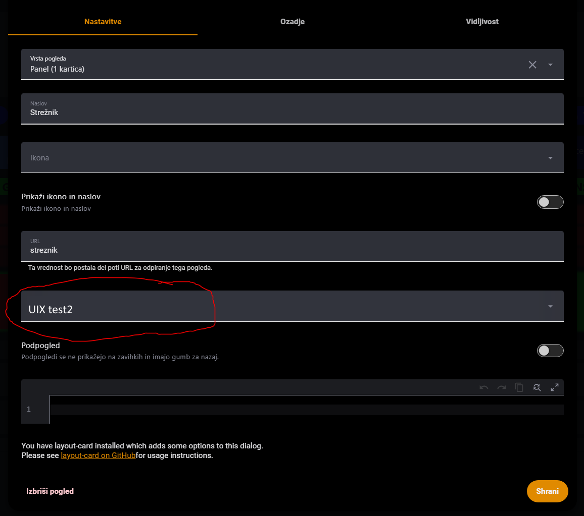

I’m ā€œworkingā€ with themes again… and i wonder something about uix in themes:
this uix:
UIX Test:
  uix-theme: UIX Test
  uix-more-info: |
    :host {
      --ha-dialog-scrim-backdrop-filter: blur(5px);
      --ha-dialog-surface-background: rgba(0,0,0,0.9);
      --ha-dialog-surface-backdrop-filter: blur(10px);
      --dialog-box-shadow: 0em 0em 2em white;
      --ha-dialog-border-radius: 2em;
      --ha-dialog-width-md: 90vw;
works if i select theme either as default HA theme or personal one - more-info dialogs are full width and background is blurred.
Then i make another similar theme, only WITHOUT full width:
UIX Test2:
  uix-theme: UIX Test2
  uix-more-info: |
    :host {

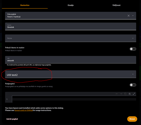

Now, if i set this theme in one view of dashboard only:
it doesn’t work: theme parts (any color changes etc…) are changed, but it seems that uix part is not read - more-info is still full-width, while it should be ā€œnarrowerā€ (normal).
Is that how it is or is there a solution for this?
What i’m trying to achieve is to have some dashboards ā€œmore-infoā€ in full-width, and some normal ones.
Most dialogs, including more-info and Browser Mod popups, are loaded in shadowRoot of <home-assistant> which is above view in DOM so will only ever get the main theme, not a view theme. So what you are experiencing is expected.
Two paths:
  1. If for built in more-info dialog styling you will need to augment your theme to use templates utlising the panel variable to adjust the style per panel. Use a good fallback technique like @Mariusthvdb does in his UIX theme.
  2. If this is specific to Browser Mod popups, then UIX theme: config variable will be able to assist, but Browser Mod needs to be updated to pass theme UIX config when applying UIX. I will build a Browser Mod beta with this change.
UPDATE: Browser Mod 3.0.3-beta.1 available which passes theme UIX config correctly.
Yes, i meant for all more-info dialogs, not only browser-mod ones. But on first look Mariusthvdb’s solution seems a bit (too) complicated for me… I don’t have a clue where to put that (and how, to be honest…)
Thanks for clarification, at least i know where i’m at. It’s not that big deal to have ALL full-width, it’s just that some of dialogs are a bit annoying when full screen (like update info’s etc)…
