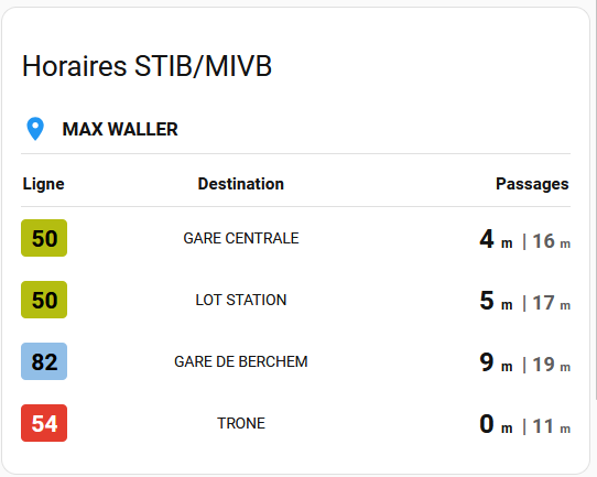

BTW, I’m using this card:
type: custom:html-template-card
title: Horaires STIB/MIVB
ignore_line_breaks: true
content: >
{% set stop_name = “MAX WALLER” %}
{# Define the GTFS Colors manually here #} {% set line_colors = {
“50”: {“bg”: “B4BD10”, “txt”: “000000”},
“54”: {“bg”: “E43C2E”, “txt”: “FFFFFF”},
“82”: {“bg”: “91BEE7”, “txt”: “000000”}
<div style="display: flex; align-items: center; margin-bottom: 12px;
  padding-bottom: 8px; border-bottom: 1px solid var(--divider-color);">
    <ha-icon icon="mdi:map-marker" style="color:#2196F3; margin-right: 10px;"></ha-icon>
    <span style="font-weight: bold; font-size: 1.1em;">{{ stop_name }}</span>
  </div>
<table width="100%" style="border-collapse: collapse;">
    <thead>
      <tr style="border-bottom: 1px solid var(--divider-color);">
        <td width="20%" align="left" style="font-weight: bold; padding-bottom: 8px;">Ligne</td>
        <td width="40%" align="center" style="font-weight: bold; padding-bottom: 8px;">Destination</td>
        <td width="40%" align="right" style="font-weight: bold; padding-bottom: 8px;">Passages</td>
      </tr>
    </thead>
    <tbody>
      {% macro render_row(entity_id, line_label) %}
        {% set state_obj = states[entity_id] %}
    {% if state_obj %}
      {% set line_id = state_obj.attributes.line_id %}
      {% set state_1 = state_obj.state %}
      {% set state_2 = state_obj.attributes.next_passage_minutes %}
      {% set dest = state_obj.attributes.destination or 'N/A' %}
      {# Get colors from the mapping above, or use fallback #}
      {% set bg = line_colors[line_id].bg if line_id in line_colors else '777777' %}
      {% set txt = line_colors[line_id].txt if line_id in line_colors else 'FFFFFF' %}
      {% set is_available_1 = state_1 not in ['unknown', 'unavailable', 'None', none] %}
      {% set is_available_2 = state_2 not in ['unknown', 'unavailable', 'None', none] %}
      <tr>
        <td width="20%" align="left" style="padding: 10px 0;">
          <span style="background: #{{ bg }}; color: #{{ txt }}; padding: 4px 8px; border-radius: 4px; font-weight: bold; font-size: 1.4em;">
            {{ line_label }}
          </span>
        </td>
        <td width="40%" align="center" style="padding: 6px 0; font-size: 0.9em; text-transform: uppercase;">
          {{ dest }}
        </td>
        <td width="40%" align="right" style="padding: 6px 0; font-weight: bold;">
          <span style="font-size: 1.6em;">
            {{ state_1 if is_available_1 else '--' }}
          </span>
          <span style="font-size: 0.8em; margin-right: 4px;">{{ 'm' if is_available_1 }}</span>
          <span style="color: var(--secondary-text-color); font-size: 1.2em;"> | </span>
          <span style="font-size: 1.2em; color: var(--secondary-text-color);">
            {{ state_2 if is_available_2 else '--' }}
          </span>
          <span style="font-size: 0.7em; color: var(--secondary-text-color);">{{ 'm' if is_available_2 }}</span>
        </td>
      </tr>
    {% endif %}
  {% endmacro %}
  {{ render_row('sensor.stib_max_waller_line_50_max_waller_gare_centrale', '50') }}
  {{ render_row('sensor.line_50_max_waller_lot_station', '50') }}
  {{ render_row('sensor.line_82_max_waller_gare_de_berchem', '82') }}
  {{ render_row('sensor.line_82_max_waller_neerstalle', '82') }}
  {{ render_row('sensor.line_54_saint_denis_trone', '54') }}
</tbody>
</table>
let’s see if I can use here your colors attributes.
