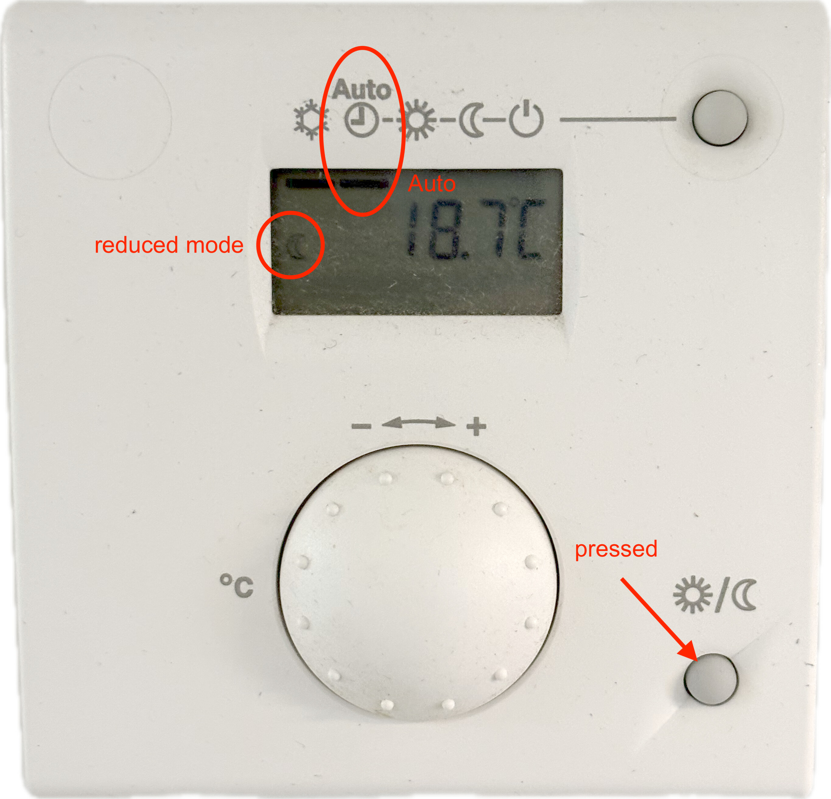

But there is also the issue that when on heating you can’t set reduced. You have to be in auto to manual be able to switch to reduced.
(edit)
I actually don’t know which parameter changes when you are in auto mode and switch to comfort or reduced? I assumed it was just parameter 700 but it is not. the parameter 700 stays on auto when switching between reduced and comfort.
@Liese
Ah I found how it works:
  • Byte 1: Operating mode (0=protection, 1=automatic, 3=comfort)
  • Byte 2 (when mode is automatic/1): Active preset
    • 0x01 = Reduced active
    • 0x02 = Comfort active
    • 0x03 = Comfort mode pushed into Reduced temporarily
    • 0x04 = Reduced mode pushed into Comfort temporarily
