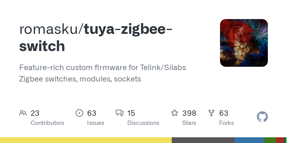

Bseed/tuya switches generally don’t have that feature but you can enable those by installing this custom firmware

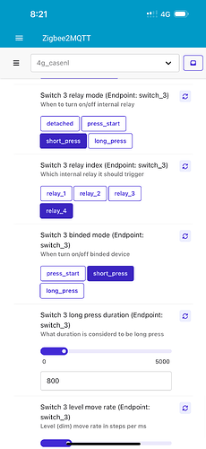

Here’s an example for my switch, they’re still working on multipress but they do have single and long press if you’re using it as scene switch in detached mode

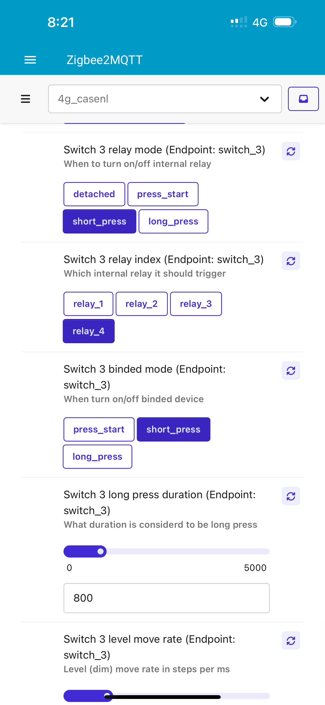

In Z2M, this switch exposes a property called ‘switch_mode’. It lets you choose a ‘scene’ mode.
In that mode, pressing the button doesn’t toggle a relay, instead it sends a specific action property within mqtt message. You can then use this in automation.
There is one catch though. It seems like there is no easy way to reset the switch to factory default when z2m or zigbee network is out - so it stays in ‘scene’ mode after power loss or re-pairing.
