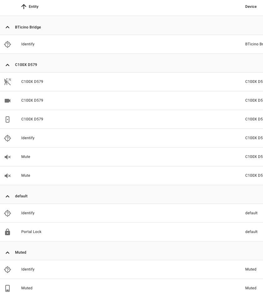

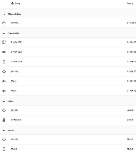

I’m kinda new to HA, and now struggling a bit with your c100x controller component.
I run it in Homekit mode. HA detected it, I’ve paired it using PIN codes from config-homekit.json (there are two different codes), and now I have several entities (see below) However the only thing that works is ā€œUnlockā€ button under the Default device. Although there are two doors/locks connected to this system, it unlocks only one, and I don’t see any way to tell it which lock to open.
There are no events coming either. When doorbell button pressed, for instance. I saw instructions to configure notifications via webhooks, but that doesn’t seem to allow same user experience as on the native door-entry app (receive a ring, turn on the camera, talk, unlock).
There are 6 entities under C100X device, what do they do then ? One of them is a sensor, but it doesn’t do anything, nor has any events… At the same time I have 3 different Mute entities… why is there so much ?
Am I missed any configuration steps, or is it all normal behavior for the Homekit mode ?
Thank you in advance.
