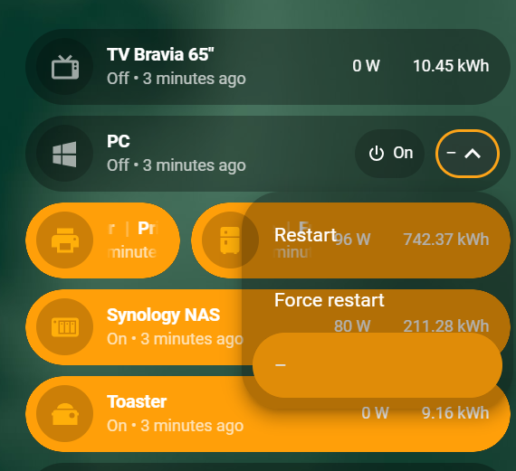

  • Fixed select_attribute dropdown appearing inside the card:
    Dropdowns now display correctly outside of the card area. #1559

Do you know if I can change transparency of the card background and keep the drop down list solid?
Presently I have the following adjustments in the module:
:host {
            --bubble-main-background-color: rgba(0,0,0,0.3) !important;
            --bubble-icon-background-color: rgba(0,0,0,0.2) !important;
            --bubble-secondary-background-color: rgba(0, 0, 0, 0.2) !important;
            --bubble-background: rgba(0,0,0,0.3) !important;
            --bubble-sub-button-container: rgba(0,0,0,0.3) !important;
            --bubble-climate-button-background-color: rgba(0,0,0,0.3) !important;
Thanks in advance

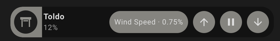

I’m customizing a bubble-card for a cover entity (cover.toldo), and I want to display a horizontal progress bar across the entire button — representing the current_position of the cover (0–100%) — but without enabling the actual slider interaction.
Visually, I want it to look like the “slider” style of bubble-card, but still use the button type for better control and layout.
Here’s what I’m trying to achieve:
  • Button layout (not slider)
  • A horizontal progress bar filling the button background depending on current_position
  • No drag or touch interaction — purely visual
How can I create a linear horizontal progress fill using CSS or templates within the bubble-card?
Has anyone done something similar?
Thanks in advance for your help! :pray:
