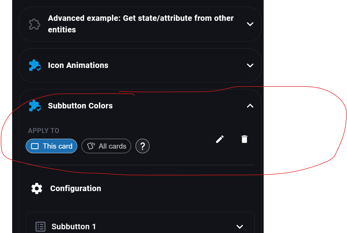

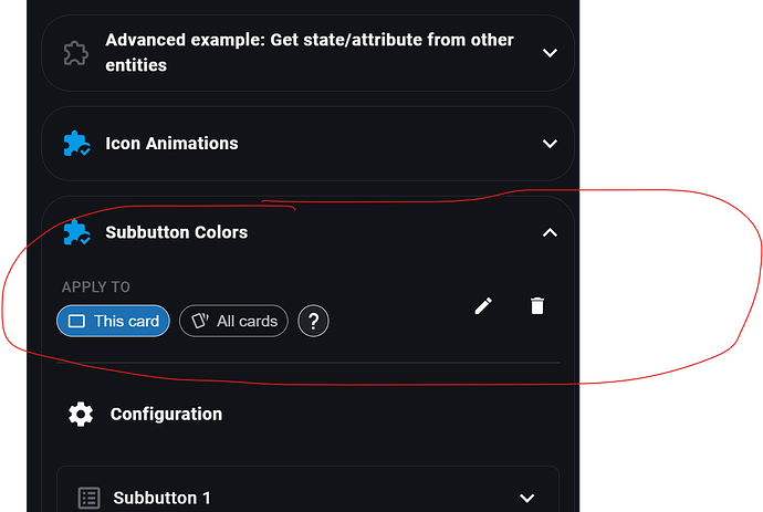

Is there a way to change the sub button colors to a specific hex code? I tried a bunch of card-mod related things that didn’t work. Thanks!
Edit, found a module that allows me to customize the colors. Unfortunately it’s limited to only the first 6 sub buttons lol.
Try to use a Modules
Yeah sorry, just found that because I saw someone else mention it. Only problem now is that it appears to only be limited to 6 icons. I’m have around 9 sub buttons, all different hue scenes.
Edit, I’ll modify the module to see if I can add additional buttons. Thanks for the guidance.
Try to add more buttons in YAML Code
subbutton7:
subbutton8:
etc.

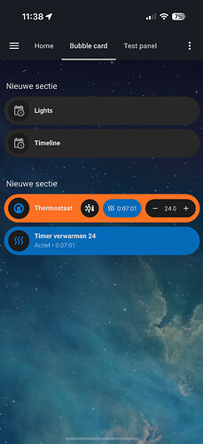

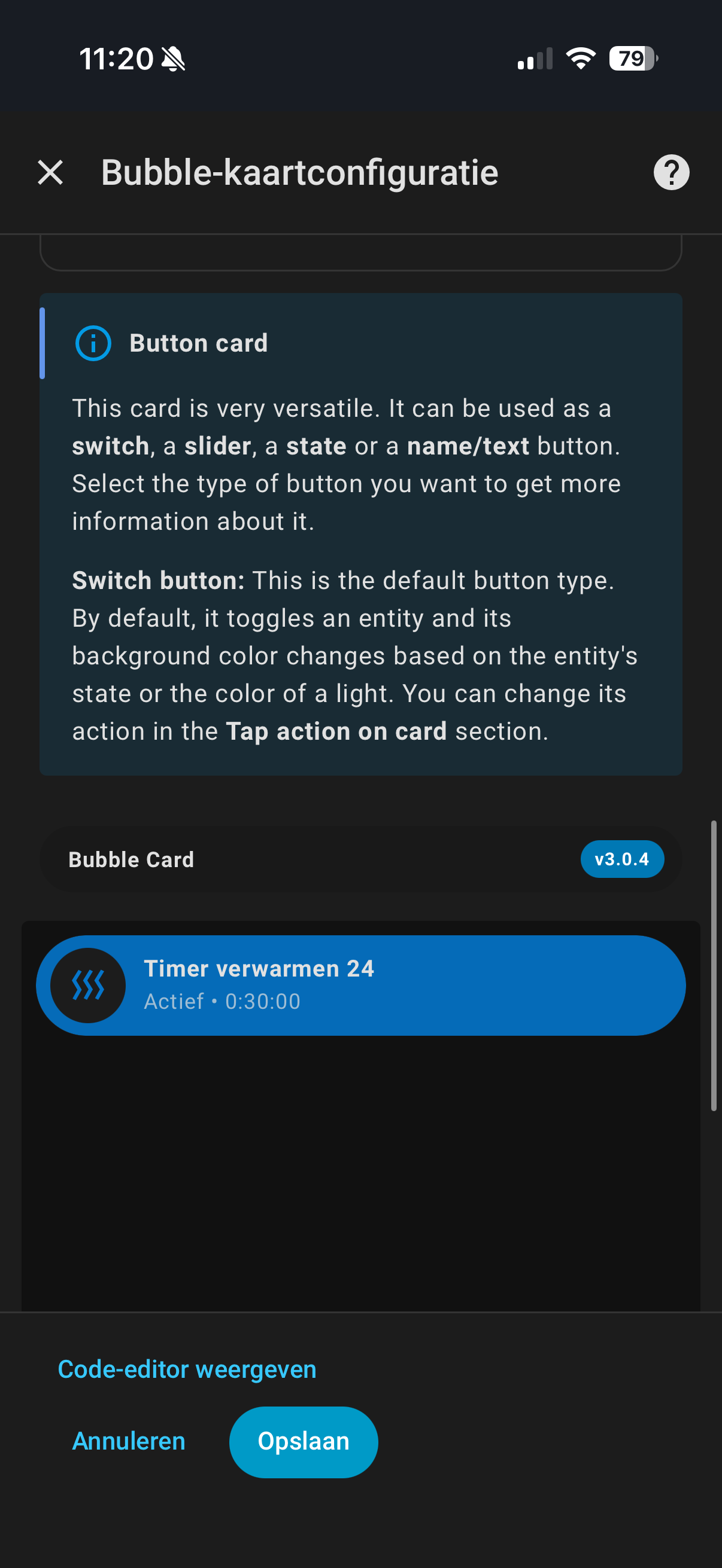

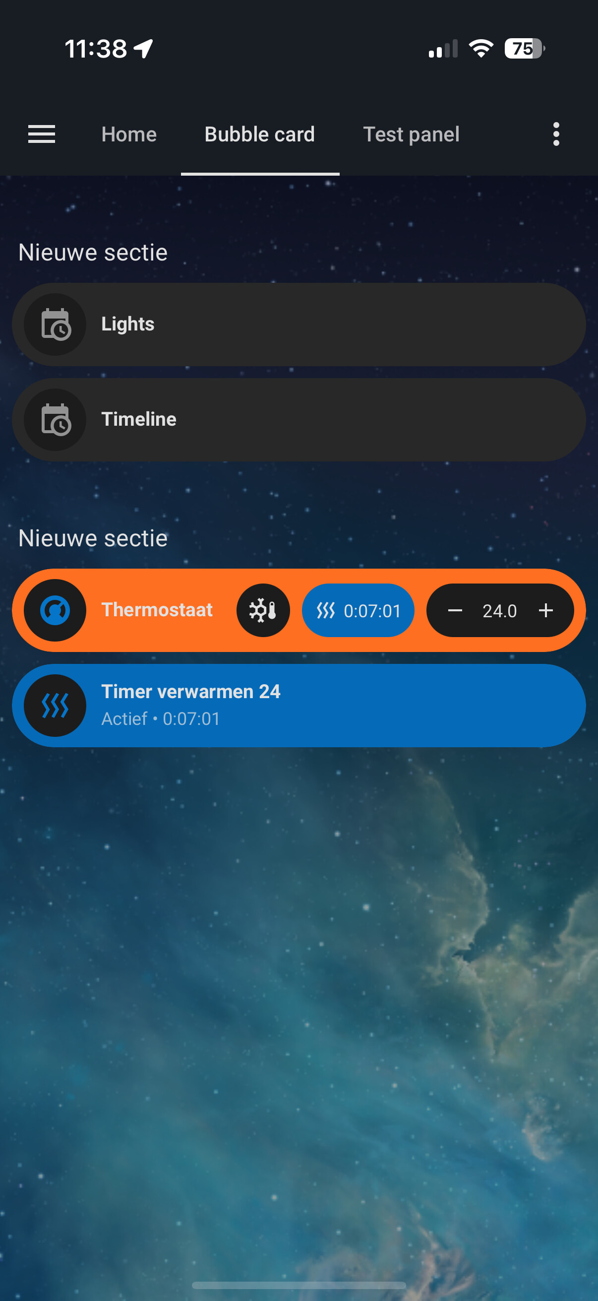

I want a bubblecard to show the remaining time of a timer.
However, it wil show the remaining time at the start, but won’t update / show live time. And yes, I’ve checked that’s its actually counting down.
I also tried it as a separate button, and (the way I want to use it) a subbutton for my thermostat.
Hopefully someone has a solution.
Small update, when I restart home assistant while the timer is running, it updates it once, but then stays at that time.

  • Timer support:
    Timer entities are now fully supported with live countdown display. Finally!

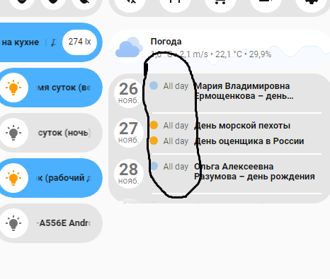

Hello. I’m using the Calendar card type. How can I remove/delete the “All day” tags?
type: custom:bubble-card
card_type: calendar

card_mod:
  style: |
    .bubble-event-time {
      display: none !important;
Bubble Card 3
