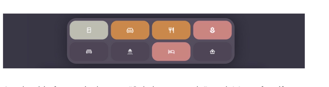

Hey,
I made a card that turns a smart plug on and off. When its off, its icon is white and when its on it turns to green. But when i turn it off, before it goes back to white it blinks up as blue for a split secound. What can I do to fix it, and remove that blue flash?
Here is my current style:
styles: |
  .bubble-icon-container {
    color:  !important;
    background: ${state === 'on' ? '#4C9031' : '#303446'} !important;
  .bubble-icon {
    background:  !important;
    color: ${state === 'on' ? '#4C9031' : ''} !important;
  .bubble-button-background {
    background-color: ${state === 'on' ? '#4C9031' : '#303446'} !important;
    opacity: 1 !important;
  .bubble-sub-button {
    color: #8d6671 !important;
    background: #8d6671 !important;
  ha-card {
    color: white !important;
i have installed the latest Beta from Bubble Card and use the Sub-Button Card.
Is it possible to reduce the distance between the two lines?
And can I change the background of the card?
Thx.
Hi! You can directly change this gap by changing the height of all your sub-buttons (in each one go to Layout).
For the background this can be done with custom styles, like for the other cards (check the examples in the documentation).

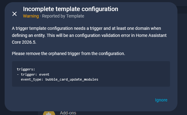

While adding some other stuff to my configuration.yaml today I got this one after restarting HA:
I’m not quite sure if I need to update this somehow or I can just remove it?
This is the complete entry for bubble card:
# Storage for Bubble Card Modules
template:
  - trigger:
      - trigger: event
        event_type: bubble_card_update_modules
  - sensor:
      - name: "Bubble Card Modules"
        state: "saved"
        icon: "mdi:puzzle"
        attributes:
          modules: "{{ trigger.event.data.modules }}"
          last_updated: "{{ trigger.event.data.last_updated }}"
Read this: Incomplete template configuration after 2025.11.0 · Issue #155893 · home-assistant/core · GitHub
Basically, the syntax is not correct: it creates an “empty” trigger and a separate sensor.
Hi! This can be ignored, since Bubble Card v3.1.0 will not use this entity anymore. Bubble Card Tools will simplify the setup of the Module Store for everyone, but also fix so many issues :ok_hand:
Ignored or removed from config after the bubble update to 3.1b*?
Those are 2 very different things…
Keeping it doesn’t have any impact, but you will be able to remove it after the v3.1.0 update to keep your configuration.yaml clean :slightly_smiling_face:

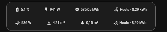

How can I change the color of the individual buttons in the Sub-Buttons-Only-Card?
Thx.
When I first tried it, I only set the height for one button. After I applied this height to all of them, the spacing decreased.
Maybe it would also be a good idea to set the height per row when there are multiple buttons.
