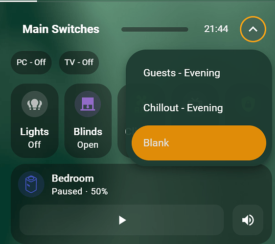

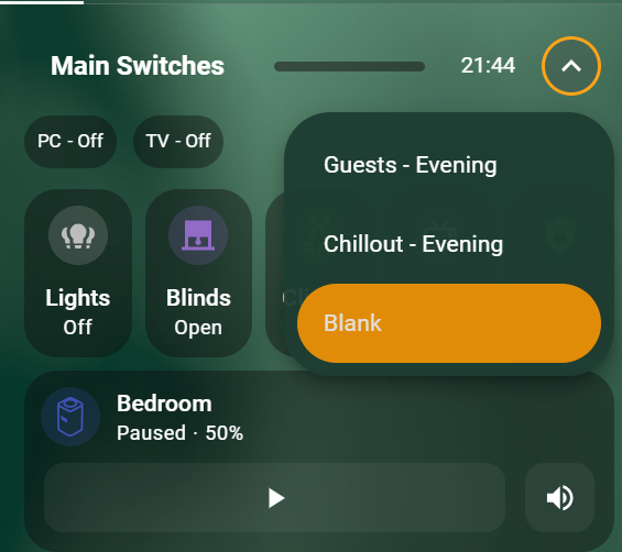

Hello guys,
Does anyone know if there is a way to re-activate a “scene” from the dropdown list if it has already been activated before?
At the moment, I have to create a dummy “blank” button that needs to be pressed before switching back to the scene, otherwise, the scene will not be triggered.

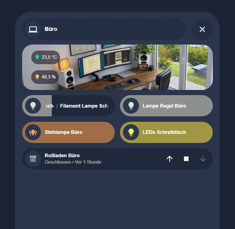

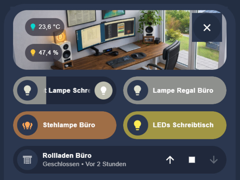

I would like to have the second bubble card (with my office image and the two sensors as sub buttons) replace the header. Meaning, I would like to have the close button on that bubble card. Is that possible?
Like so (but the close button being more translucent):
Does anyone know what to do?
Got it to work myself:

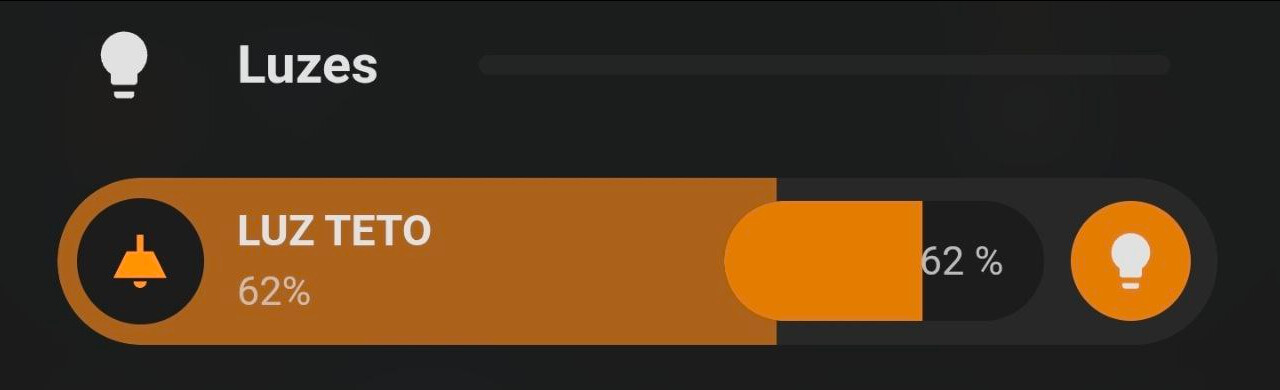

I´m having some trouble to use the slider sub button. I would like it to control the color temp, but it remains as a brightness control. I already tryed many things.
Here is the code and a print of what I’m getting:
        sub_button:
          - entity: light.h801_1
            sub_button_type: slider
            attribute: color_temp
            show_background: true
            show_icon: true
            fill_width: false
            show_attribute: true
            always_visible: true
            slider_options:
              min: 150
              max: 500
              step: 1
I would appreciate any comment to point me to the right direction

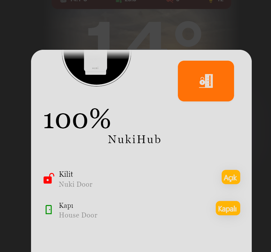

Just trying to make the background of a Popup transparent, for a normal bubble card it’s not an issue. But how is this possible for a popup? In the styles documentation GitHub - Clooos/Bubble-Card: Bubble Card is a minimalist card collection for Home Assistant with a nice pop-up touch. there is an example but it’s mentioned there this will not work for the popup. Any idea?
