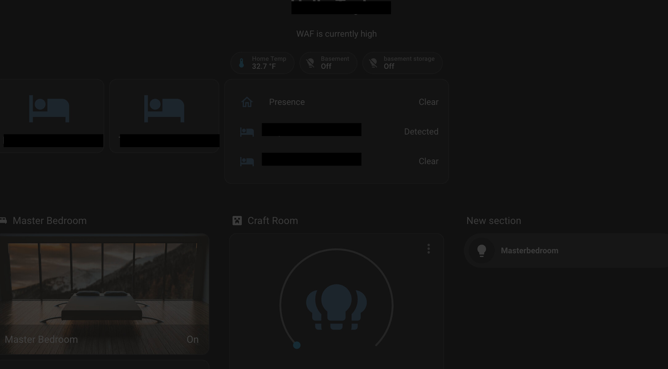

Seems Copilot is not that bad on this. This style section is working for me:
    styles: |
      /* Ensure all pop-up layers are transparent */
      .bubble-pop-up-container {
        background: transparent !important;
        box-shadow: none !important;
      .bubble-pop-up-inner {
      .bubble-pop-up-background {
      .bubble-card-container {
As well setting Opacity & Blu to 0
bg_opacity: "0"
bg_blur: "0"
Hope this is also helpful for others

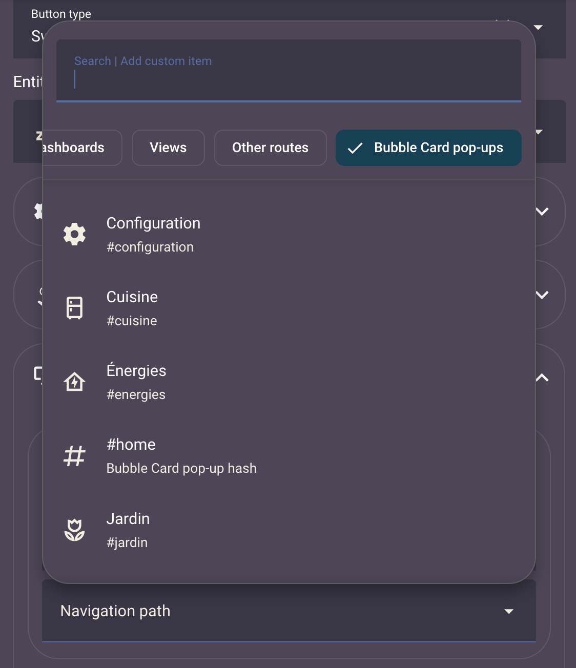

  • Existing pop-up hash in navigation dropdown:
    Existing pop-up hash values are now shown in the “Navigation path” dropdown. This also fixes the impossibility to add a hash since the Home Assistant 2026.2 update. #2232 #2203

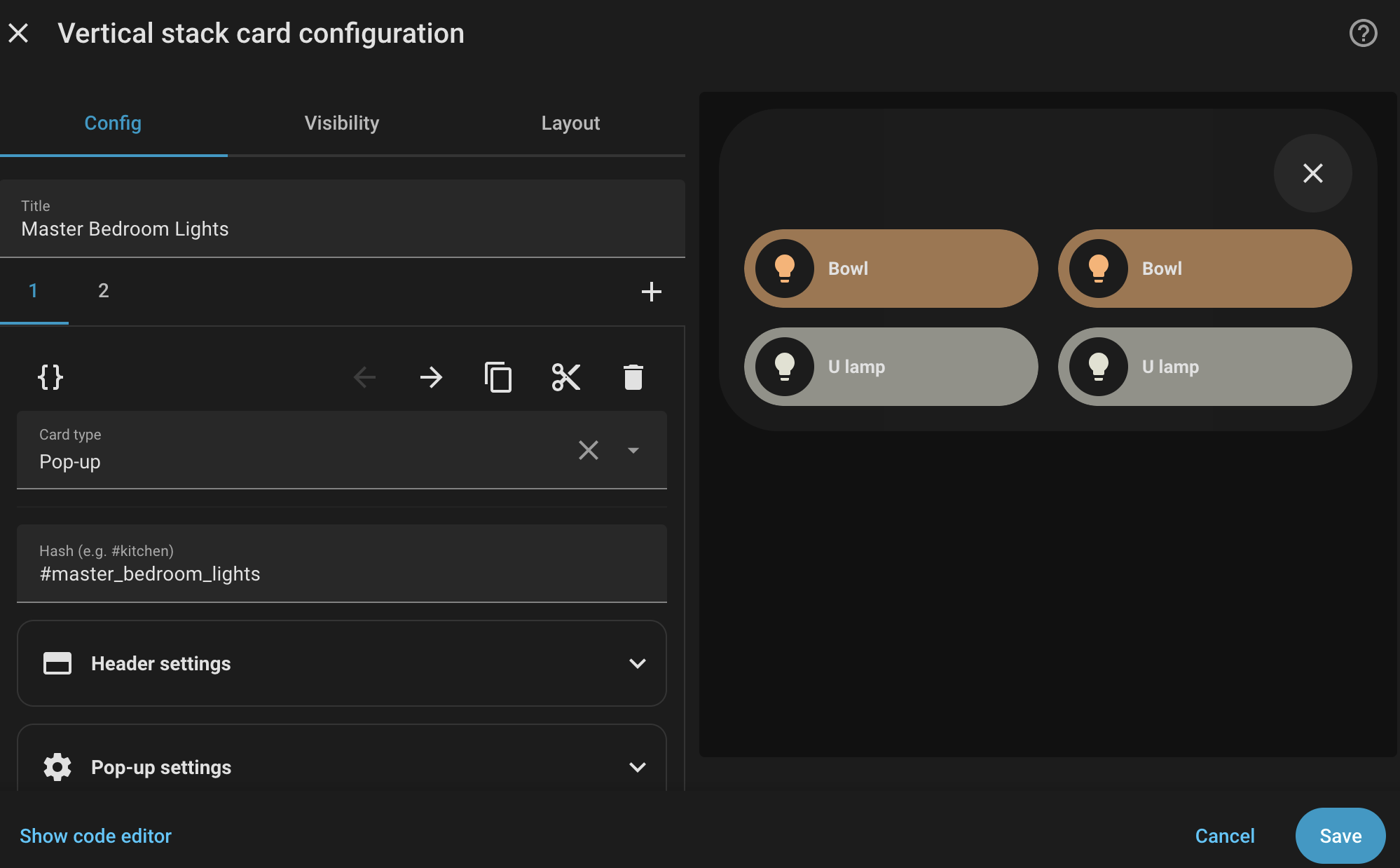

“Bubble Card doesn’t support Jinja templates”
I’m having an issue using a single light group to activate a popup card with 4 lights (the lights that make up the group)
type: vertical-stack
cards:
  - type: custom:bubble-card
    card_type: pop-up
    hash: "#master_bedroom_lights"
    button_type: name
    sub_button:
      main: []
      bottom: []
    slider_fill_orientation: left
    slider_value_position: right
  - type: horizontal-stack
    cards:
      - type: vertical-stack
        cards:
            card_type: button
            button_type: switch
            sub_button:
              main: []
              bottom: []
            entity: light.master_bedroom_bowl_light
            card_type: button
            button_type: switch
            sub_button:
              main: []
              bottom: []
            entity: light.ikea_of_sweden_floor_lamp_ww_light
        cards:
            card_type: button
            button_type: switch
            sub_button:
              main: []
              bottom: []
            card_type: button
            button_type: switch
            sub_button:
              main: []
              bottom: []
title: Master Bedroom Lights
Sometimes I get the animation of the popup with a slight dark tint over everything and then it’s hard to close out of. I can refresh the screen and it will load up the pop-up card improperly and then disappear.
sometimes it will briefly pop-up a card with 3 lights in a horizontal layout. I am using the pop-up fix but it doesn’t make a difference.
This is what it looks like when building it in the editor
This is what it looks like when I click on the button activating the pop-up
would love any help!
