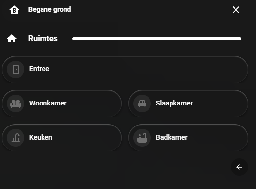

Thanks for the code @GeorgeCastanza
Do you know why it looks on desktop as shown below?
It looks only so, when using it within a bubble-card popup. Do you have an idea @Cloos ?

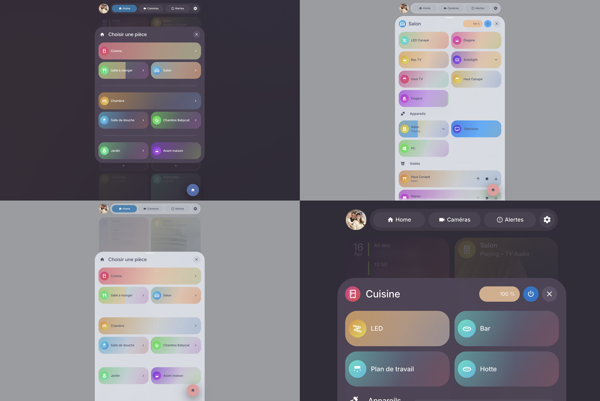

Pop-ups are now much more flexible visually thanks to these new modes. You can keep the familiar full pop-up behavior, switch to a more compact mode that fit the pop-up’s content for a cleaner layout, or use a centered dialog style when you want something… well different.
A second pop-up style is now available. The new Classic style gives pop-ups a more traditional dialog/header look, while the default one keeps the more modern Bubble Card feel. The modules used for the buttons are available on my Patreon here. The header is still a work in progress.

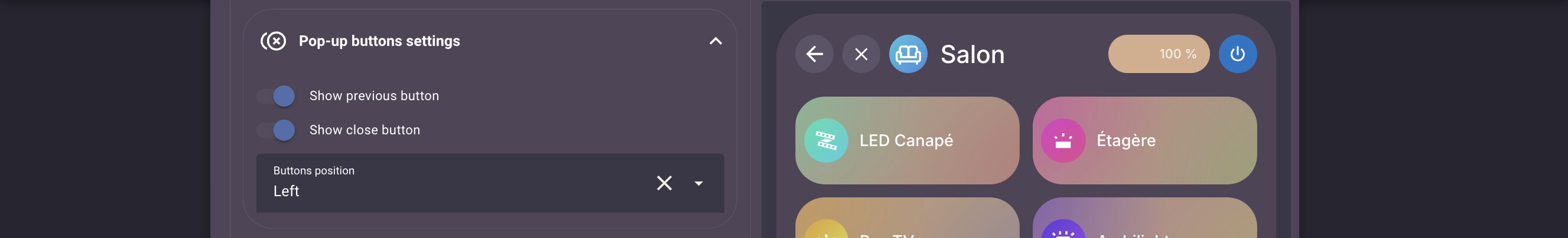

Better pop-up header controls
Pop-up headers are now more customizable. You can show a Previous button to return to the last opened pop-up when available, hide the close button while keeping the rest of the header visible, and place the header buttons on the left or on the right. For example, you can open a “Living room” pop-up, jump to a smaller “Lights” pop-up, then use the Previous button to go back instantly.
