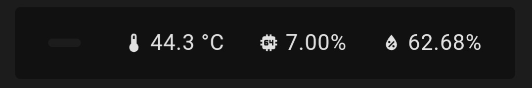

type: custom:bubble-card
card_type: separator
sub_button:
  - entity: sensor.processor_temperature
    show_background: false
    show_state: true
  - entity: sensor.processor_use
    show_state: true
  - entity: sensor.weather_room_humidity
    show_state: true
  - entity: sensor.weather_room_temperature
    show_state: true
How to decrease the spacing between sub button entities?
I have one more sensor entity to fit in the same row.
Kindly guide
