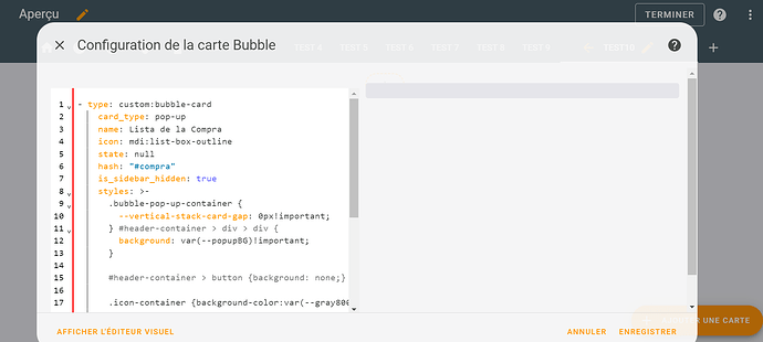

Capture d'écran 2024-11-05 152338
I would like my cards in the pop-ups to be with this format
edit: can you give me the code for :
A pop-up
and
A button to open the pop-up
please, sorry i’m very newbie

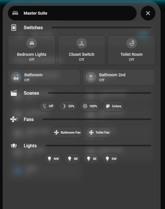

I am having a problem with the beta releases. On 2.2.4 my popups work fine. When I upgrade to the latest beta release whatever popup button I press I just get the same broken popup and I’m not sure why.
Here is my dashboard / buttons
Here is a popup on 2.2.4
and here is a popup if I install the new beta version.
I’ve tested this on PC browser, phone browser and tablet kiosk browser and all of them are broken.
Any advice on what I might need to fix to get the beta working?
I tested the card goes back up well but I don’t have the “opacity” or the contours as circled in the photo.
I admit I don’t understand … are you using a particular theme?
Is it possible to change the size of the bubble card container that HA itself recognizes?
I want to make the card larger but it’s not large enough for this to be fixed using section layouts and this way it’s overlapping the other one.
I’ve tried changing margins in the css of ha-card element but that did not help.
This is the code i used to make the card larger:
.bubble-button-card-container {
  margin-top: -7px !important;
  height: 70px !important;
Hi! I haven’t changed anything that could do that, you are the first to raise this issue.
Have you checked your browser console as well? Any error in it?
