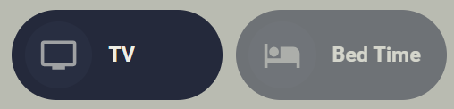

Thank for all of the work you’ve put into this! I’m wondering what I am missing, I am just using the bubble button card to call a service and active a scene or script. However, the color shows grayed out for the ones tied to a script.
type: horizontal-stack
cards:
  - type: custom:bubble-card
    card_type: button
    button_type: switch
    tap_action:
      action: call-service
      service: scene.turn_on
        entity_id: scene.tv
    button_action:
      tap_action:
          entity_id: scene.tv
    entity: scene.tv
    card_layout: large
    card_type: button
    button_type: switch
    icon: mdi:bed
    tap_action:
      service: script.bedtime
      target: {}
    button_action:
      tap_action:
        target: {}
    entity: script.bedtime
    card_layout: large
Screenshot 2024-11-09 145508
Hi! I probably haven’t covered that case yet, but you can use a “Name/Text” button, then change the Button action to script.turn_on and add you entity there.

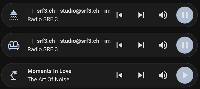

In a media-player card… is it impossible to show the media player name regardless of player state?
type: custom:stack-in-card
title: ""
mode: vertical
cards:
    card_type: media-player
    name: Sonos Family Room
    show_name: true
    show_state: true
    scrolling_effect: true
    hide:
      volume_button: true
      power_button: true
    styles: |-
      .bubble-media-player-container {
        color: white !important;
        background: rgba(7, 103, 215, 0.24) !important;
        border-radius: 10px;
        border-style: solid;
        border-width: 1px;
        border-color: rgba(7, 103, 215, 0.5) !important;
      .bubble-icon {
        color: rgba(7, 103, 215, .8) !important;
      .bubble-sub-button {
        background-color: rgba(7, 103, 215, 0.24) !important;
        border-radius: 12px;
      .bubble-icon-container {
        background-color: rgba(7, 103, 215, 0.1);
        border-radius: 20px;
        border-width: 1px;
      .bubble-play-pause-button {
        color: White !important;
      .bubble-previous-button {
      .bubble-next-button {
      .bubble-volume-button {
    entity: media_player.sonos_family_room
    show_last_changed: true
    hold_action:
      action: none
    double_tap_action:
      action: none
    tap_action:
      action: more-info
    sub_button:
      - entity: media_player.sonos_family_room
        icon: mdi:volume-high
        tap_action:
          action: more-info
        show_name: false
        show_state: false
        show_last_updated: false
        show_attribute: true
        show_background: false
        attribute: volume_level
card_mod:
  style: |
    ha-card {
      --ha-card-background: rgba(7, 103, 215, 0.24);
Hi, it’s not possible at the moment, there is not enough space for that when a media is playing. My advice is to add a separator below it with the name/location of that media-player.
Got it! Thanks I’m updating an old media player view and this should be a big improvement… especially when I start playing with pop-ups.
I also stumbled across this a few days ago.
Maybe an option to have the player name where currently the artist is written in combination with “this is a title - and this the artist” scrolling string above as an option would be cool?
On pages / sections that are dedicated to a room, the current setup is perfect.
But I also have a dedicated media page, where I would love to have such an option. :slight_smile:
I use the Icon to indicate which player is playing… I dont need the pictures of the sound that is playing…

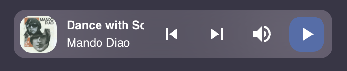

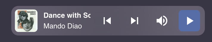

One question about your example with the rounded rect cards using a different corner radius (which looks very cool btw. :blush:):
You are already chaining Variables from more specific to more general, so it’s easy to overwrite single elements like e.g.:
var(--bubble-media-player-icon-border-radius, var(--bubble-icon-border-radius, var(--bubble-border-radius, 50%)))
What I’m missing is a border radius for cards and one for content elements in this chain.
Like 50% → General Theme Radius → Card-Radius or Content Radius → Specific-Element-Radius → …
The reason is the “fat corners” effect that you get when you add the same corner radius to nested elements (as long as we don’t talk about 50% / full circles).
Normally you have to decrease the inner radius by the distance to the outer one.
For bubble cards, this would be 6px. Which means for cards with a radius of 12px an inner elements radius of 6px would be perfect.
Fat corners:
Fixed corners:
More details:
Currently you have to use the general theme border radius to set the card corners and then dig through all stylesheets and set all other variables to the smaller radius (which are already a lot and might get more with more card types :wink: )

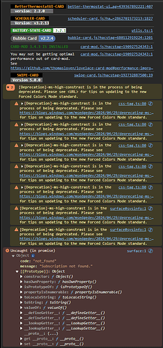

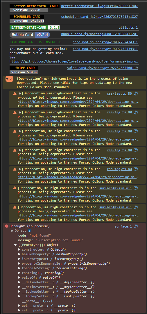

I have something similar.
on 2 Devices my Popups are shown unclear.
Have some errors in the console but i cannot handle it.
On My iOS Devices iPad & iPhone with App an MSEdge everything is shown correct.
On My Ubuntu with MS Edge and 3200x2000 Resolution i have this Problem.
And on my Windows 11 with Edge, Firefox, Chrome with 2560x1140 Resolution i have this Problem.
Second screen in second Post
Tried to Emulate other Resolutions / Devices on windows with Edge but same Problem.
