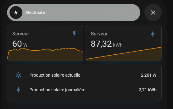

Here what the dashboard looks like now:
If I click on a button:

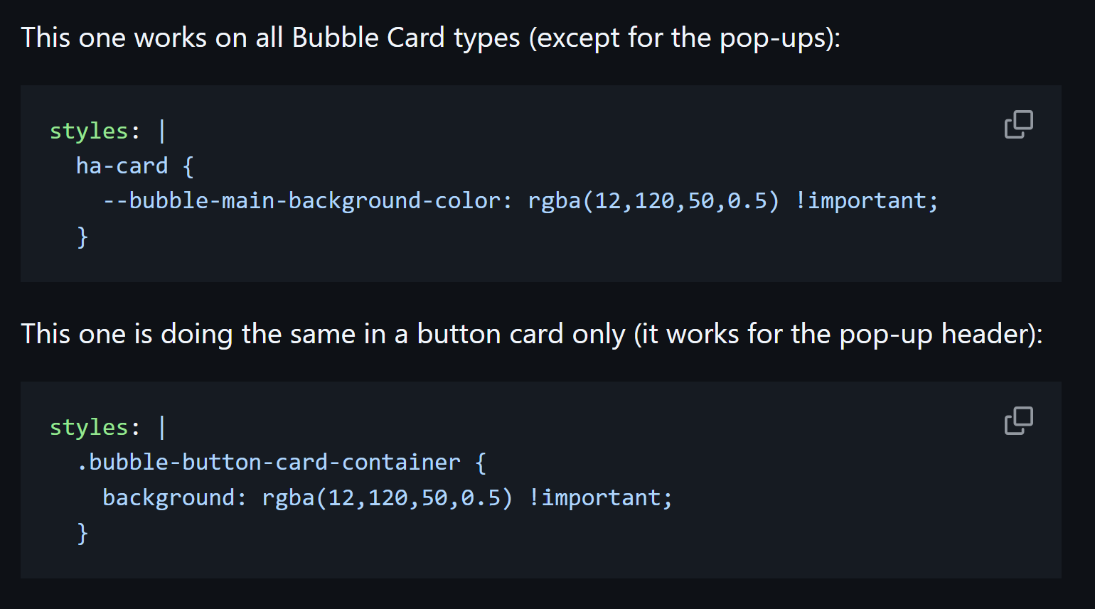

I checked the documentation for the card and according to what it says the background styling code that you're using only applies to pop-up cards. Try using the alternative code and it should work, it did for me.

You do not have to change the button type you just need to use the correct code.
If your button switch is NOT part of a pop-up use the following:
styles: |
  ha-card {
    --bubble-main-background-color: rgba(12,120,50,0.5) !important;
However, if your button switch IS part of a pop-up then use the following.
styles: |
  .bubble-button-card-container {
    background: rgba(12,120,50,0.5) !important;
Thank you again for your help.
