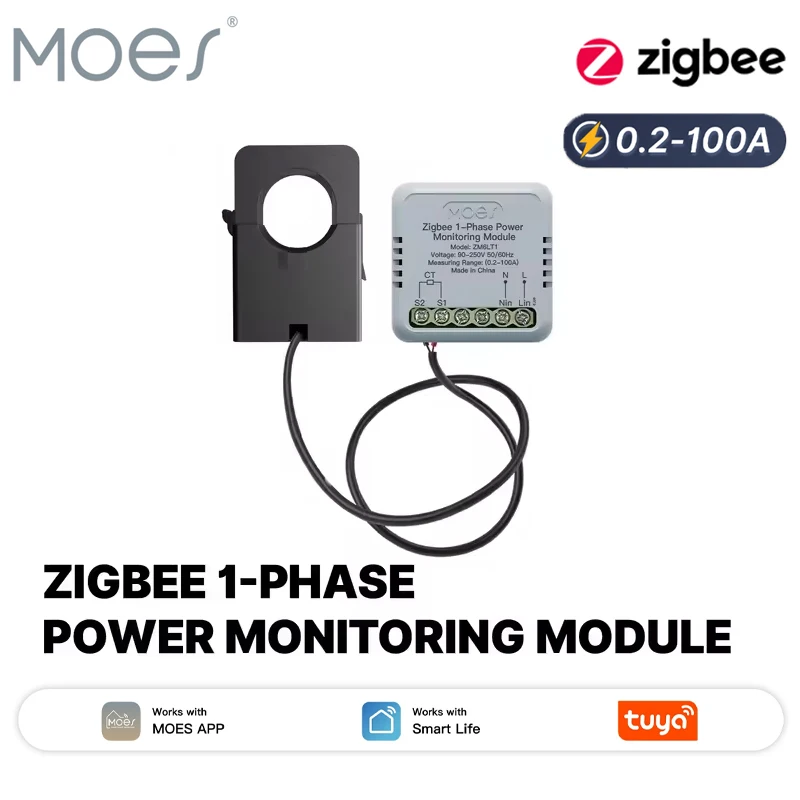

MOES is usually a pretty reliable brand if you want something on the cheaper side:
Otherwise most relays with a clamp with the correct amp rating will do the job once installed to monitor power draw.
I would recommend not using zigbee for this specific application - especially when you are going to do a bunch of those.
The reason being, zigbee is relatively low bandwidth in exchange for power efficiency. And energy monitoring is a high data rate application, so the chance of message saturation could become a concern.
