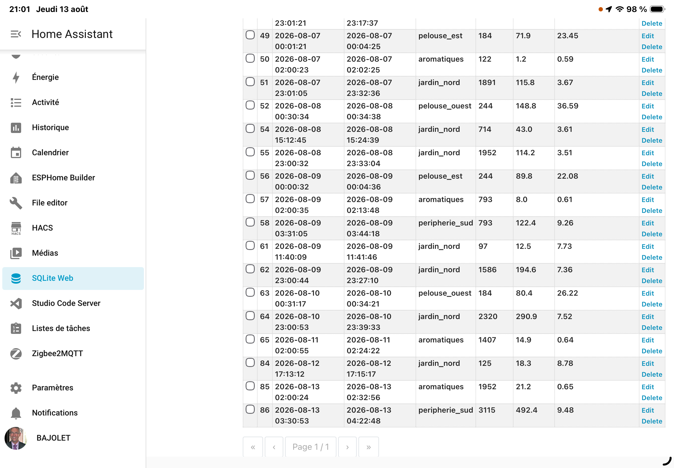

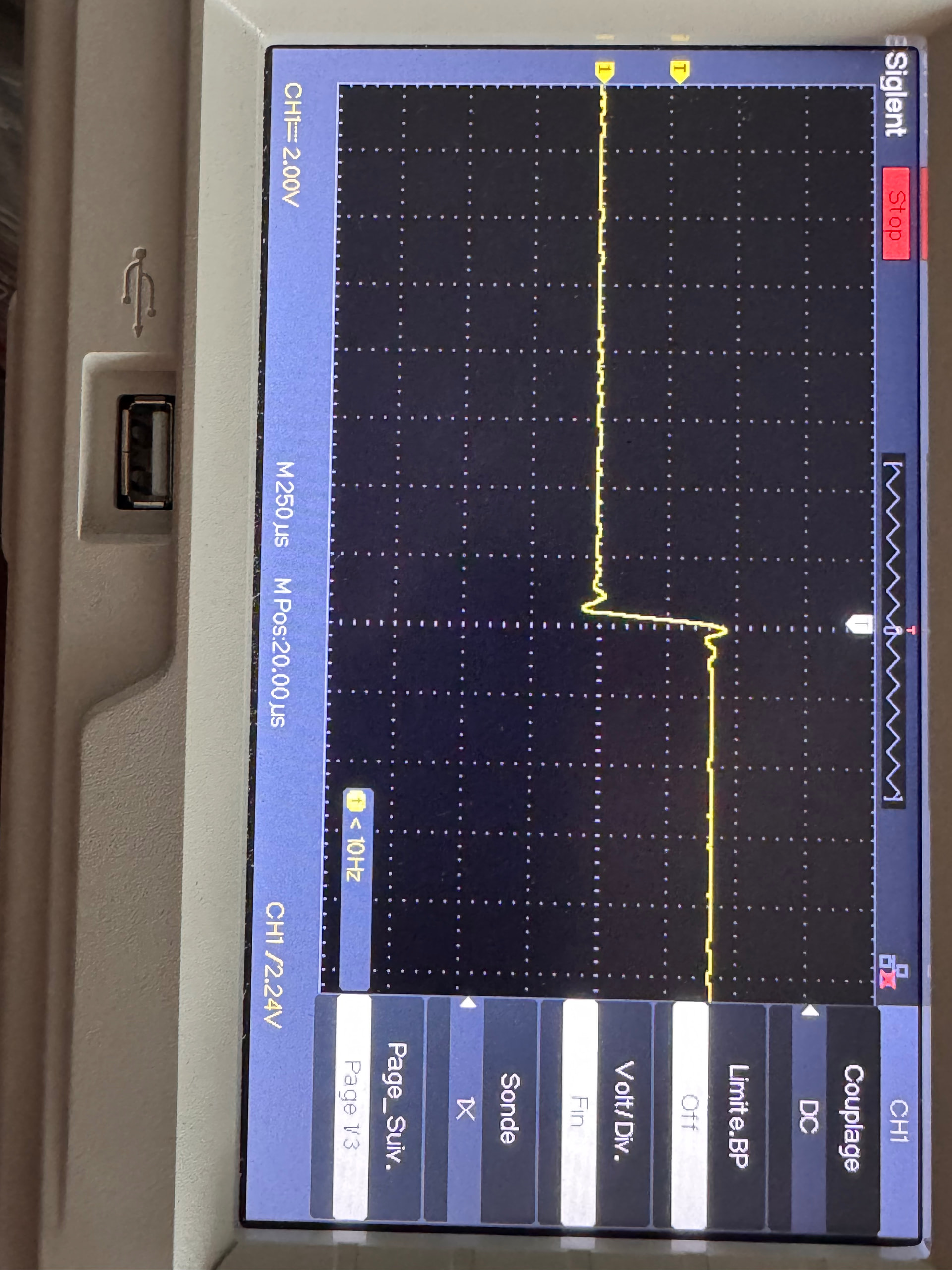

The problem is that my data-base was corrupted with strange and wrong data. The GPIO is a signal which is coming from a valve: I got the signal 24 volts AC, I transformer it in DC, after I have an opto-coupler with transform the signal to 0 or 3.3 volts DC, I checked the signal with a scope, and it is clean, the change between 0 —> 1 or reverse is transmitted to Home-assistant without problem.
Here is a view of the signal change, the voltage is only 3.12 volts

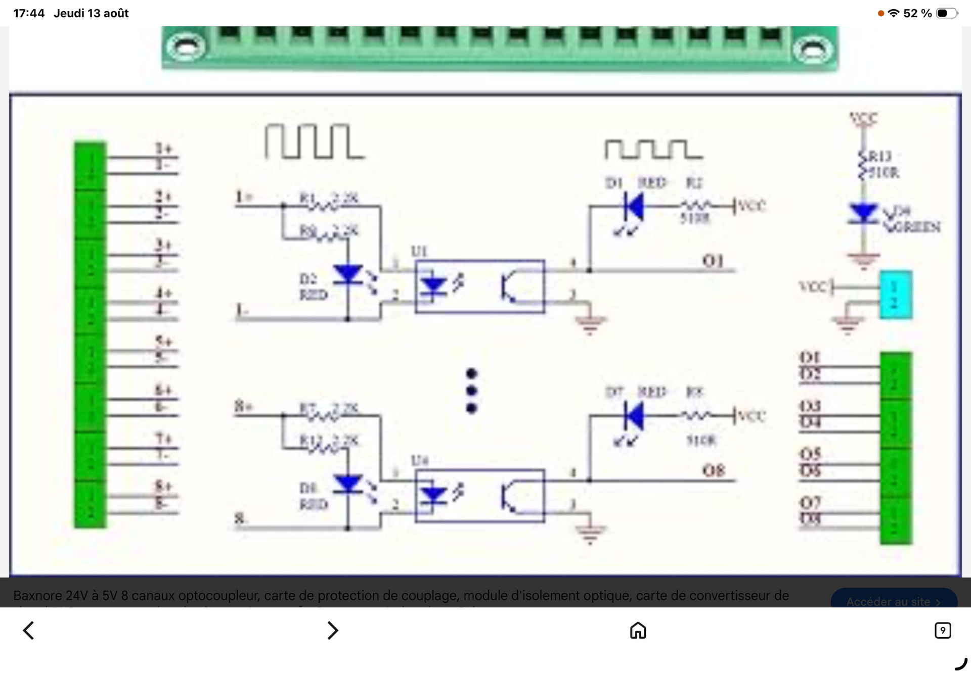

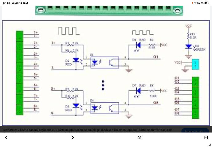

The interface opto-coupler is similar to the attachéd picture, do you need that is it nécessaire to add an option es pullup or pulldown?
I think it has sufficient pullup via 510R+LED.

My database is SQLite, the wrong data were erased, Maybe that the word « corrupted » was wrong, During the problem (watering) the data were wrong

N° Durée (s) Volume (L) Débit (L/min)

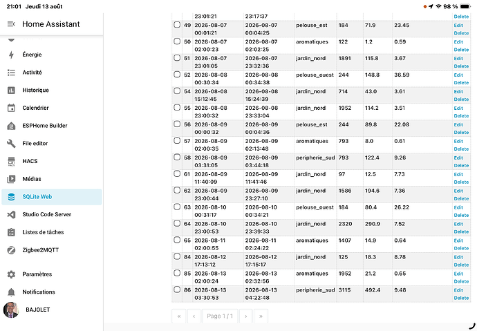

Here are the wrong data Line 77 —> 79, the data are out of range
Great, finally something that makes sense. The data stored in the database is not what you expect. (I don’t believe it is actually corrupted.)
I suspect your device is not working the way you expect it. So now you need to capture the esphome logs from the device when the data going to the database is incorrect. This will show if the error is in the device or after it leaves there on its way to the database.
