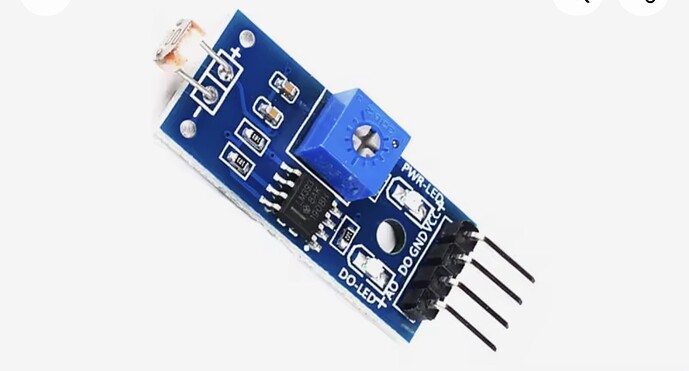

Hi, i would like to build a device to detect a headlight double flash. I plan to use this as a way to trigger my automatic gates to open from inside my property, mostly to save the poor Amazon driver exiting his van to press the gate open button.
Would it work If i were to place a LDR sensor module at the end of a short black tube so that the sensor is in shade until a vehicle facing the tube flashes its lights?
Is this likely to work? Is there a better way to detect headlight flashes?

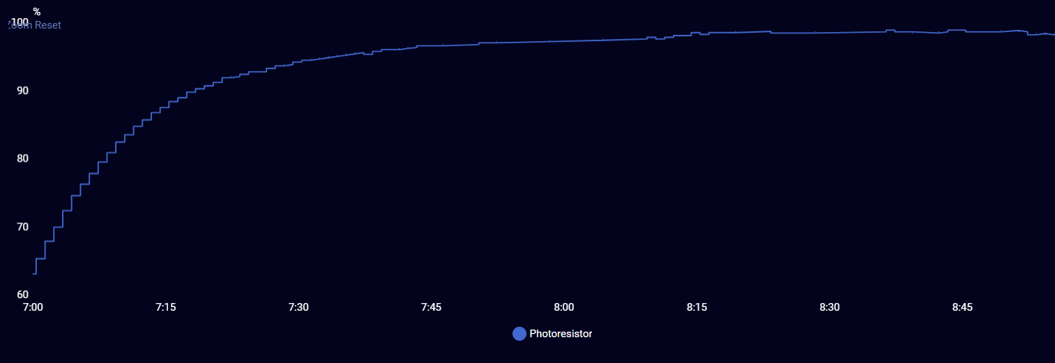

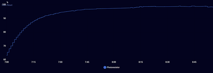

I don’t think an LDR will work. In daytime even on a cloudy day it will be saturated with light.
This is my LDR this morning. It’s still dark at about 80% and 99% it’s dull outside. Headlights will never be able to compete with daylight.
I use this to turn on my lights inside when it drops below 91% in the evening.
…but this is HA so experiment.
I figured by placing the LDR in a horizontal black tube i could limit the ambient light. But i think you’re right and thats why this isn’t something ive seen before.
Yes, if the tube is not too short, it’s on correct height well aligned and you use the analog output of the sensor to detect sudden change on corresponding light level.
I’ll build and give it a trial for a week or so.
