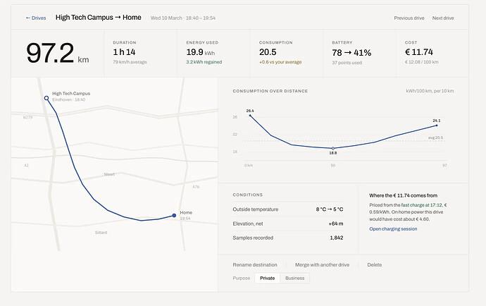

I’m building an open-source drive and charging log on top of BMW CarData — the layer above the sensors. It turns the stream into actual drives and charging sessions, with history, cost per session, and efficiency over time. Roughly TeslaMate, but CarData-native.
Here’s where the UI is at, running on invented data for now:
