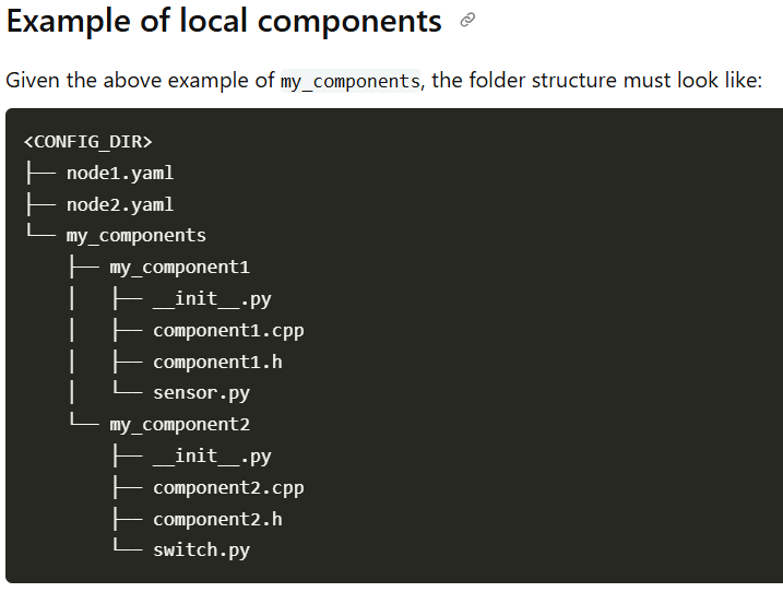

Likely the folder (source) shouldn’t have same name with files inside
I don’t think this is the problem. I just try to rename the files and change the include in the cpp and still the same error on line 33 in python file.
I also tried with an original cse7761 directory clone (without changing any code line, but changing the filenames and the namespace) and got the same error.
There is something I don’t understand, but I don’t know what ant then I don’t know what to seach for.
The external component documentation is quite small… Just telling how to include it. Is there a bigger reference documentation ? I don’t find anyone.
OK, I just understand what you just tell me and in fact I didn’t see that there where a global my_components directory containing several my_comp_1…etc… components directories. I thought the several components directories were directly in the esphome directory.
That was my mistake : thank you :slight_smile:
The folder source must be in a global folder component.
In my-sonoff-powct.yaml, I changed :
external_components:
  - source: my_cse7761
with :
  - source: my_components
    components: [my_cse7761]
and placed my_cse7761 directory in a my_components directory itself in the esphome directory. Then it worked (at least i get c++ errors so it find the component).
