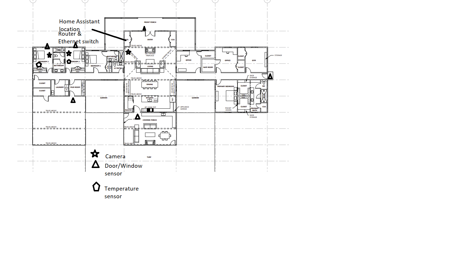

I can post my house/lodge plans to getter a better idea of how to set up my house if helpful and I can also label my current idea to see if there can be any improvements/changes made.

The two plans are included, the long structure is the house and the square structure is the lodge.
I would run 2 separate HA instances - 1 for the house, and another for the lodge.
HA currently has no comprehensive user permissions, so running everything on a single server means your more curious guests might end up controlling stuff in the main house.
You will still be able to access both instances from your browser, and the HA app will let you define multiple servers which you can switch between using gestures.
Same goes for zigbee - given you don’t mention the distance between the house and the lodge, you will probably struggle to have everything on a single mesh. Having two separate zigbee networks will ensure that the sensors in the lodge aren’t trying to bridge the gap between the lodge and your house.

My house and lodge over about 200 yards away. I would use two separate HAs 1 for each structure.
As far as the zigbee devices. Would you suggest using zwave instead for the structures I have? I’m not sure if i like the idea of having to have multiple smart plugs installed throughout the house especially having a two year old running around (and another one on the way).
