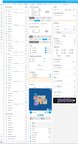

Dare I boast that almost everything in my 115 year-old California home is automated and that over the last decade I’ve tried most major products (screenshot attached as proof).
