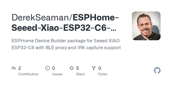

With info from following sources and no AI i got my first DIY device for thread:
It acts as router (extending network) and can report sensor data, so far.
