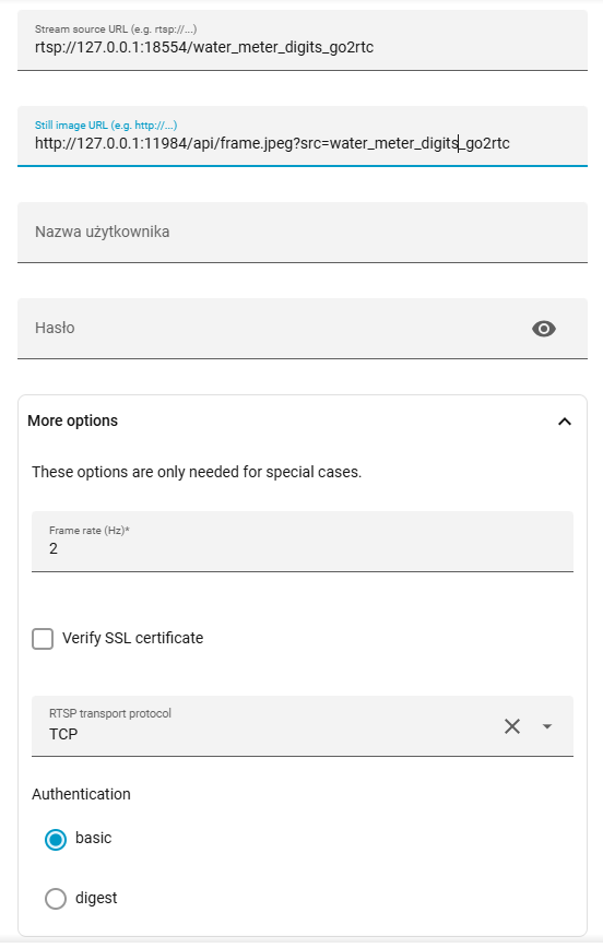

When I try to add camera wth Generic Camera integration:
I get this error in logs:
Error from stream worker: Not Found error opening stream (Server returned 404 Not Found, rtsp://127.0.0.1:18554/water_meter_digits_go2rtc)

Have you changed the go2rtc ports? Because the default port numbers are 8554 and 1984. You can also replace 127.0.0.1 with the LAN address of your HA device, e.g. I have this and it works:
  url: "http://homeassistant.mydomain.com:1984/api/frame.jpeg?src=akuvox"
You can test this in your browser.
You don't need this unless you've disabled default_config, as it's included in the default config.
These configuration options don't exist, so they have no effect. https://www.home-assistant.io/integrations/go2rtc/#go2rtc-configuration-variables
You're supposed to put the RTSP stream URL of the camera, not localhost.
HA manages the go2rtc server itself. When you add a generic camera it will add the RTSP url to go2rtc. It creates the stream, it doesn't consume it from go2rtc.
