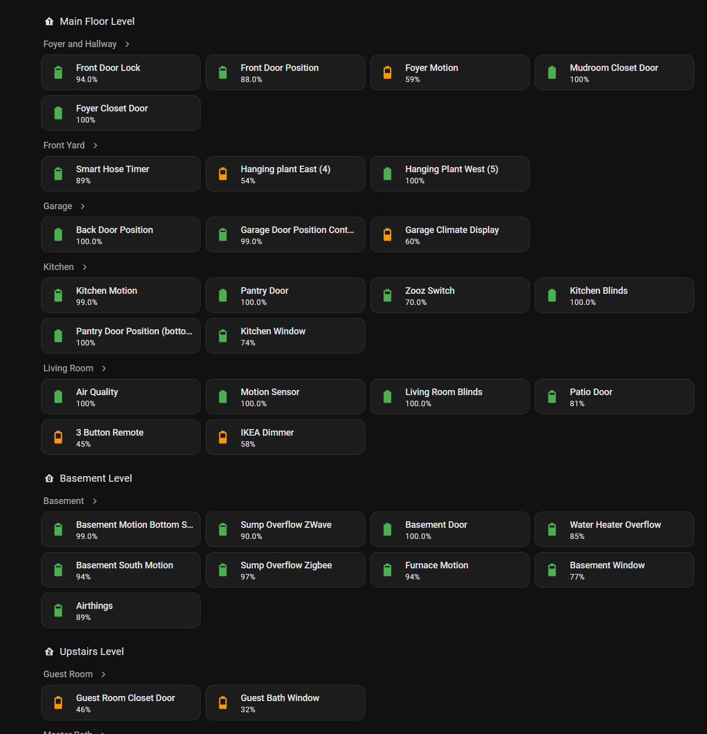

I love the new "built-in" maintenance dashboard showing all the battery levels. However, the icons turn yellow (warning) below 60%. Many of my devices stay below 60% for most of their battery life, so the color is not helpful as a warning. Is there a parameter that modifies this level? Or is it hard-coded and cannot be changed?

FWIW, the real warning comes into play below 25%, when the icon turns Red. I’m not sure I’d change how it plays out now, but it would be nice to have a say.
I believe it’s below 25%, because I only have one battery showing at 24% (that trigger could be a bit higher for all I know).
