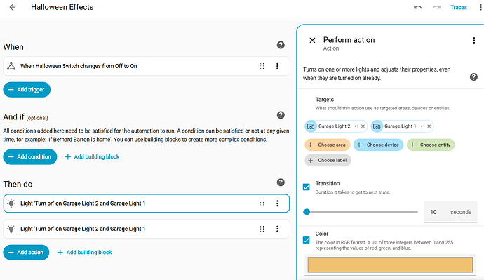

I just started an automation called Halloween Effects. I created a virtual switch to trigger it. I’m trying to change the garage light bulb colors from orange for 10 seconds, then purple for 10 seconds. So I copied and pasted the orange change, and just changed the second color to purple. But when I run it the bulbs I only see purple, I never see the orange.
I think I’m on the right track but what am I missing?
-Thanks

Here is the YAML:
alias: Halloween Effects
description: ""
triggers:
- trigger: state
entity_id:
- input_boolean.halloween_switch
from: "off"
to: "on"
conditions: []
actions:
- action: light.turn_on
metadata: {}
rgb_color:
- 240
- 193
- 112
transition: 10
device_id:
- e085850df40edb4693f31f0d1017b539
- fc316b0ddb7a86504d4b67e672f218ff
metadata: {}
rgb_color:
- 206
- 112
- 240
transition: 10
device_id:
mode: single

That’s not yaml if it’s not formatted correctly like you were advised to do in the post just above yours.
Anyway, I see your issue. The automation doesn’t care about your transition & fires the orange command immediately followed by the purple command.
Just add a delay of 10s between your 2 actions and your issue should be fixed.
