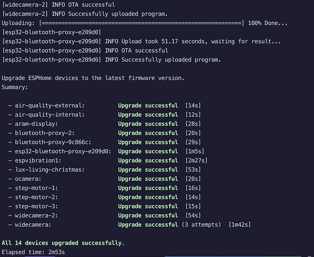

  • Parallel OTA upgrades with configurable concurrency, retry logic, and a colored summary table

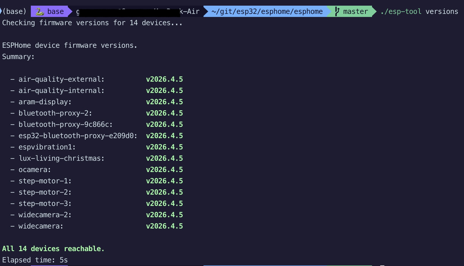

  • Firmware version check across all devices simultaneously

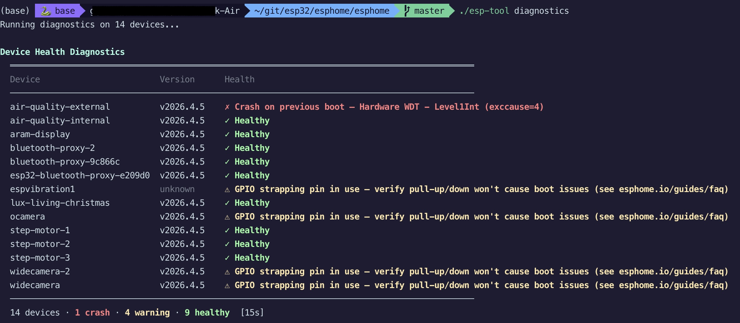

  • Boot diagnostics โ€” detects prior crashes (hardware WDT, exceptions), bootloader age, chip rev, GPIO strapping conflicts, and more

Typical post-release workflow:
bash
pip3 install esphome --upgrade
./esp-tool versions          # confirm all devices reachable
./esp-tool upgrade           # flash everything in parallel
./esp-tool upgrade --filter bluetooth-proxy-9c866c   # retry any failures

Screenshot for upgrade command output:
In addition it has two useful commands diagnostics and versions commands with screenshots:
versions โ€” fleet-wide firmware version check
Connects to each device's live log stream in parallel, grabs the reported ESPHome version from the boot output, and exits. No need to SSH into devices or check the HA UI one by one.
./esp-tool versions                          # check all devices
esp-tool versions --filter ocamera,widecamera # check a subset
esp-tool versions --timeout 20s              # allow more time for slow devices
Prints a colored summary table โ€” green for reachable with version, red for unreachable. Useful as a quick sanity check before and after a bulk upgrade to confirm everything came back up on the expected firmware version.
diagnostics โ€” boot health analysis across the fleet
This is the command I wish I'd had earlier. It connects to each device's live log stream in parallel, captures the initial boot dump, and analyses it for known problem patterns โ€” without you having to read through raw ESPHome logs manually for 14 devices.
./esp-tool diagnostics                        # check all devices
./esp-tool diagnostics --reboot                 # soft-reboot each device first, then capture fresh boot log
./esp-tool diagnostics --filter air-quality-external,aram-display --verbose
What it detects:
  • Crash on previous boot โ€” hardware watchdog timer (WDT) resets, software exceptions, stack overflows. If a device has been silently crash-looping, this surfaces it immediately across the whole fleet in one pass
  • Bootloader too old for OTA rollback โ€” flags devices that need a one-time USB flash to get a modern bootloader before OTA rollback will work safely
  • Bootloader supports SRAM1 โ€” identifies devices where enabling the SRAM1 flag would give you an extra +40 KB of IRAM, useful if you're running close to memory limits
  • Chip revision โ‰ฅ 3.0 โ€” flags devices where setting minimum_chip_revision in your YAML could reduce binary size
  • GPIO strapping pin conflicts โ€” detects when a GPIO you're using in your config overlaps with ESP32 hardware strapping pins, which can cause unpredictable boot behavior
  • Multiple OTA platform configs merged โ€” catches a subtle ESPHome config issue where multiple OTA blocks are silently merged in ways that may not match your intent
The --reboot flag is particularly useful after a bulk upgrade โ€” it soft-reboots each device and captures a clean boot log, so you're not reading stale pre-upgrade diagnostics. Combined with --verbose you get the raw log lines alongside the parsed health table.
