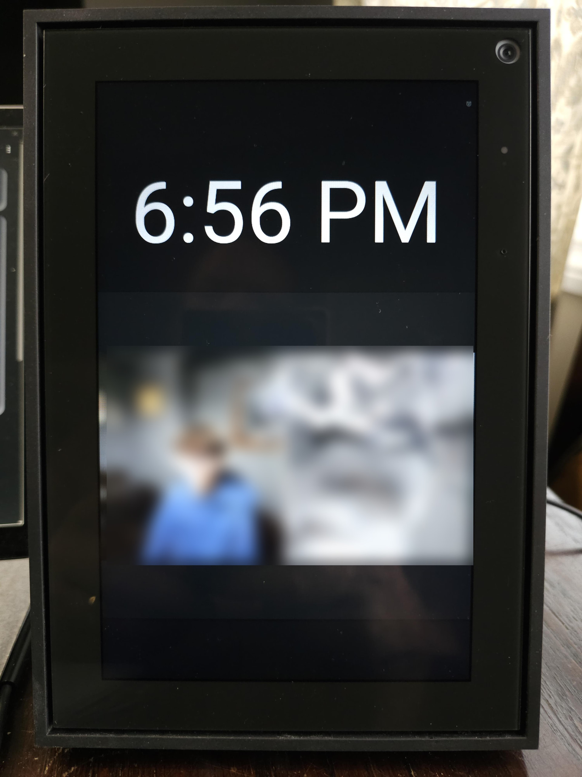

The clock, with photo slideshow

Big, clean digital clock

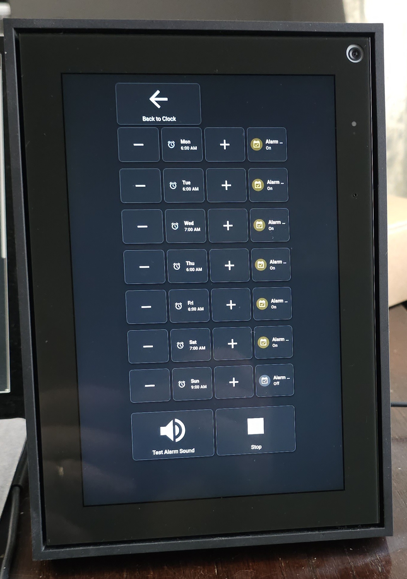

A dedicated Alarm Schedule page — one row per day, big +/- buttons that nudge the time (5 or 15 min, your call), a toggle to turn that day on/off, no text entry anywhere

Optional photo slideshow filling the bottom half of the screen (via the excellent album_slideshow HACS integration) — totally optional, easy to remove if you just want the clock

The screenshot above
Alarm schedule settings page
That’s the full schedule page — seven day rows, minus/plus/toggle, no text field anywhere, plus the Test Alarm Sound button at the bottom for dialing in volume without waiting for a real alarm.
