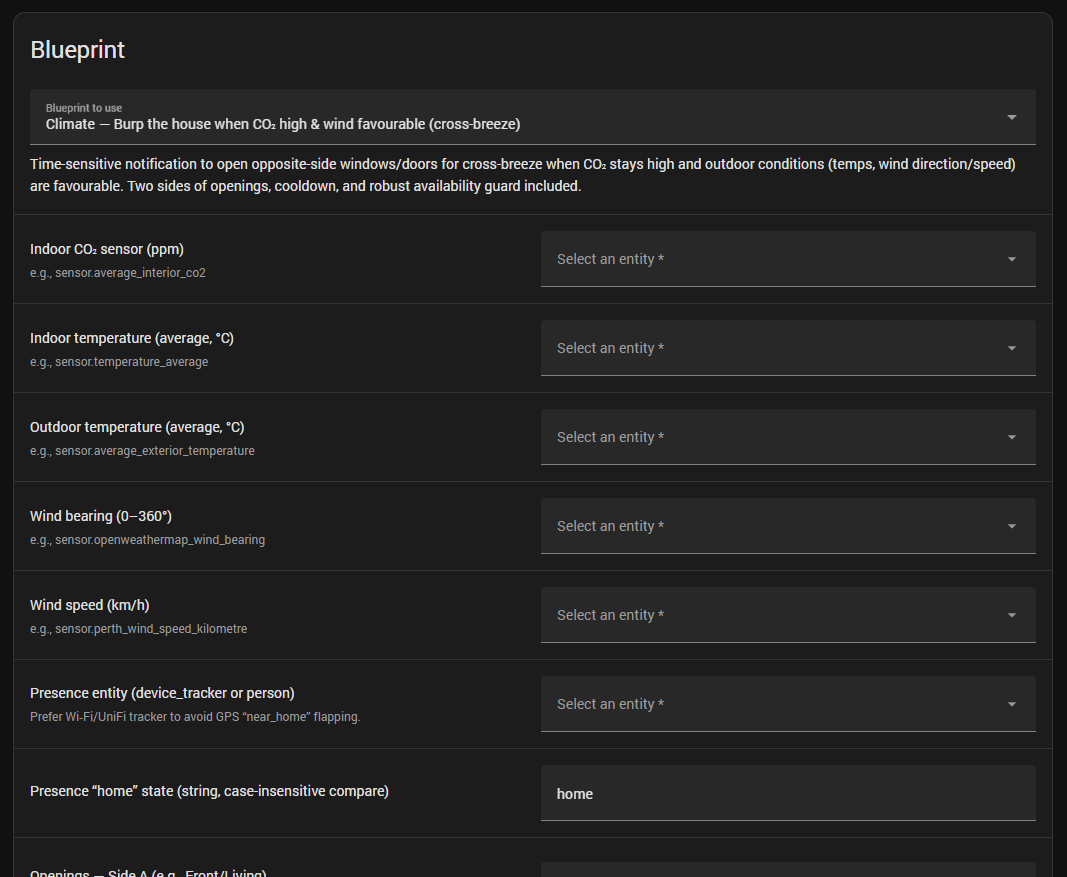

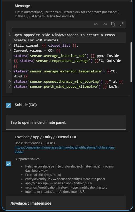

  1. A blueprint for notifying when it’s time to open some windows
    (Direct link to code with detailed instructions and documentation)

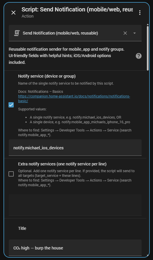

  2. A reusable and device agnostic notification script to consistently send push notifications, where the HA companion app is installed on a target device and properly configured, and work on a better notify entity with decent UI to use doesn’t seem anywhere close to fruition.

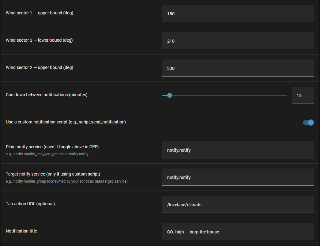

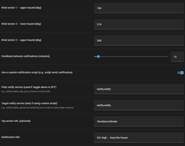

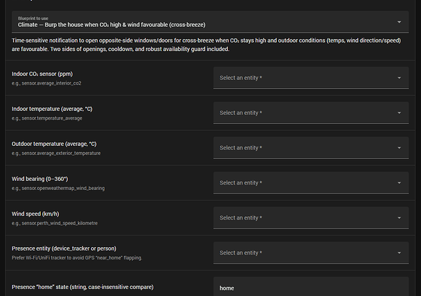

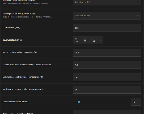

  • Send a time-sensitive notification for opening windows/doors to create a cross-breeze when CO₂ is sustained high AND outside conditions are favourable (cooler outside, wind direction/speed helpful), but only when someone is home, and with a cooldown to avoid spam.
  • By being a blueprint, you can easily configure the devices you need for each sensor, and your local information, without needing to get down and dirty with the YAML constantly.

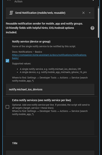

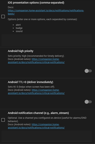

What does the notification script solve, and how does it help
  • Deals with the nightmare of sending notifications in HA

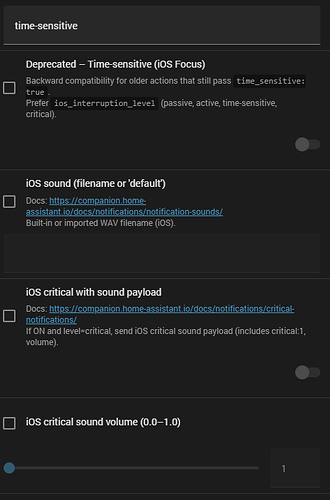

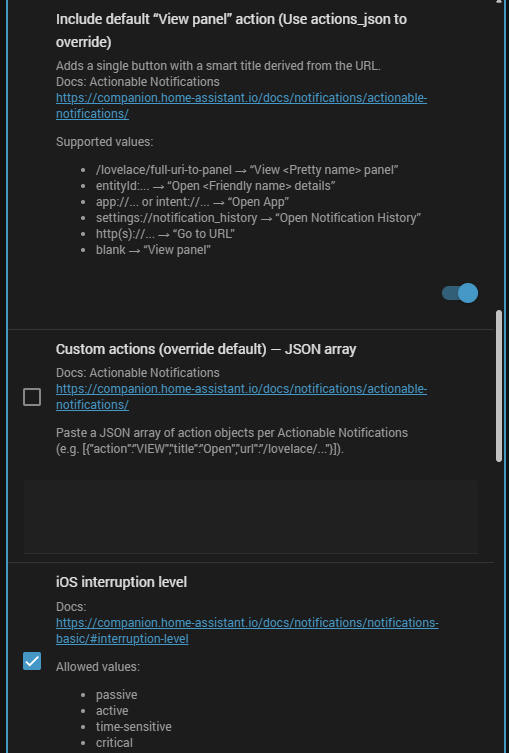

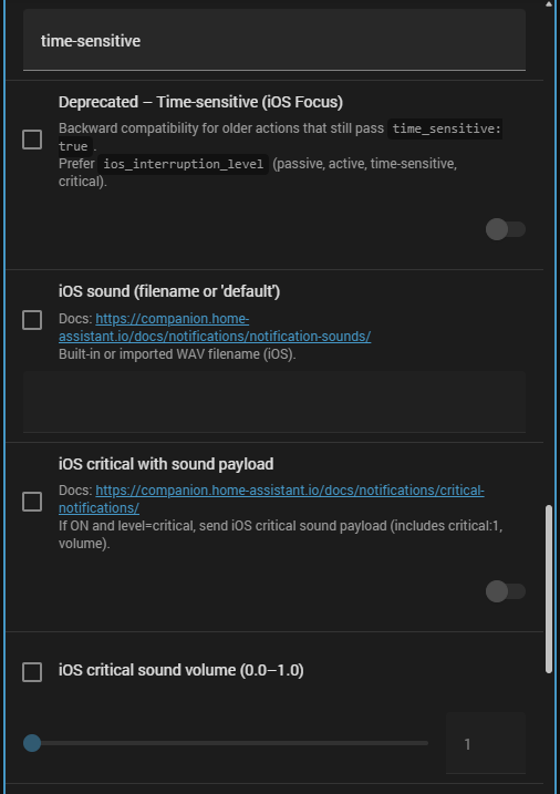

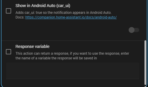

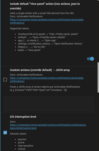

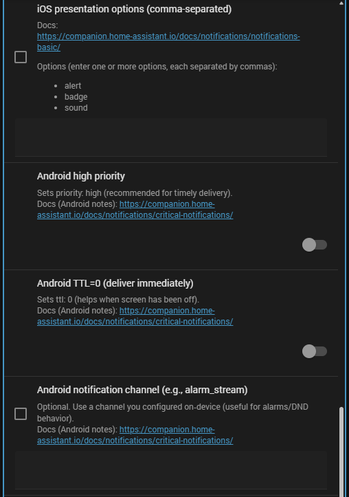

  • Accepts a variety of inputs and options (title, message, url, iOS/Android specific options - i.e. time-sensitive or critical alerts), and
  • Sends to one or more notify services (device or group) for delivery via the HA companion app on the target device(s).

  • For the blueprint, there’s even helpful information on how to get the compass bearings for your location to calculate when the wind direction will help you create a cross-breeze from one side of the house to the other

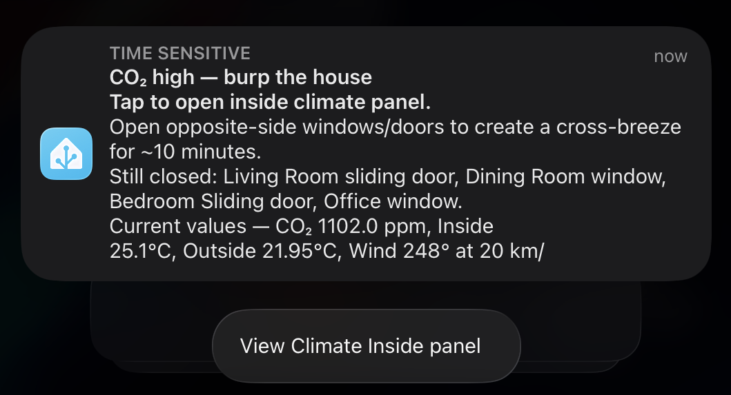

Notification
Here’s an example of the notification generated by the script when the automation/blueprint is triggered:
