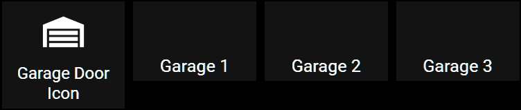

The dashboard card looks like this:
Using the sensor.garage_door_icon directly shows that I have set the icon. However, when I try to copy this to the garage_door_button button-card the icon does not appear. (As you can see I’ve tried a few variations to no avail).
The state of the sensor.garage_door_icon entity in Developer Tools → States changes correctly (between “closed” and “open”), and the icon attribute also updates to the correct mdi: icon. However, the icon on the button card itself remains blank.

As this is within custom button, for sure you must use javascript syntax, like
icon: |
    return states['binary_sensor.garage_door_opening'] === 'off'
      ? 'mdi:garage-variant' : 'mdi:garage-open-variant';
And also for custom button “Garage 1”:
icon: "[[[ return states['sensor.garage_door_icon'].attributes.icon; ]]]"
As for the first button (not custom), I honestly don’t know what’s the expected behaviour, i.e. if it should change the icon when its entity’s icon changes.

I’ve revised my dashboard card to this single button:
type: vertical-stack
cards:
  - type: horizontal-stack
    cards:
      - name: Garage Door
        entity: switch.garage_door_button
        type: custom:button-card
        tap_action:
          action: toggle
        show_name: true
        show_icon: true
        icon: |
            return states['binary_sensor.garage_door_opening'].state === 'off'
Which is what you’ve provided plus a little pokeing around of my own (the .state and the lower case ‘off’). It’s working great now! I couldn’t have done it without you - I had no idea this JS syntax was an option.
