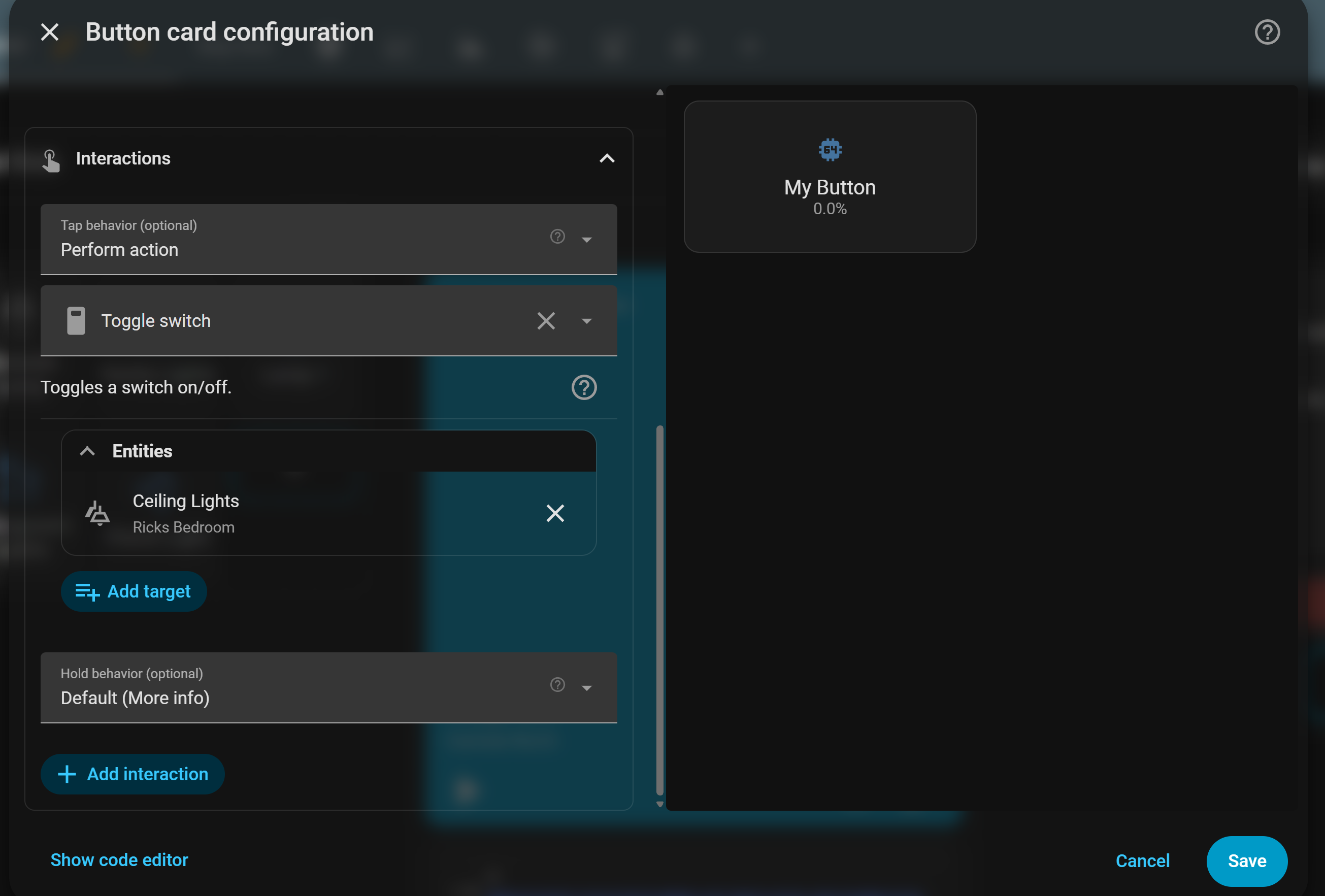

The button can have the entity with the value assigned to it and the tap action can be a toggle action targeting another entity (same with any card that supports actions I believe). This button is showing my samba app cpu usage but tapping it would switch on my bedroom ceiling lights.
