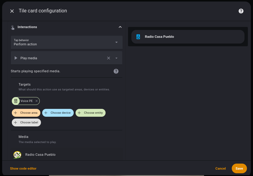

Choose a card that allows actions, then use perform-action as the tap-action.
In the following Tile card example, that can be found under Interactions:
The media_player.play_media action will allow you to use the media selector to choose the radio station when you are setting up the card.
Here's the YAML configuration for the Tile card

The issue is that I am not able to identify the link to enter into “media_content_id”
If you set up the card using its UI you don’t need to supply that, it is supplied by the Media selector.
