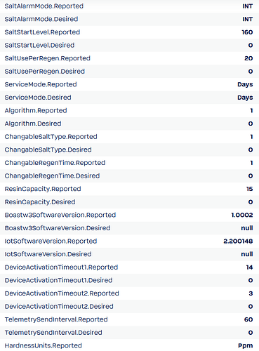

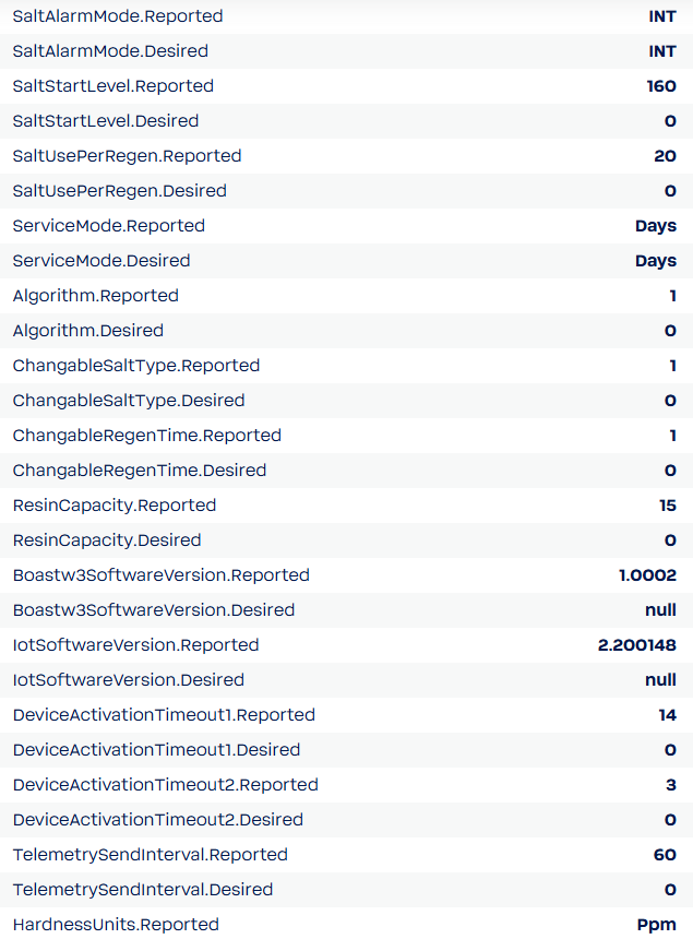

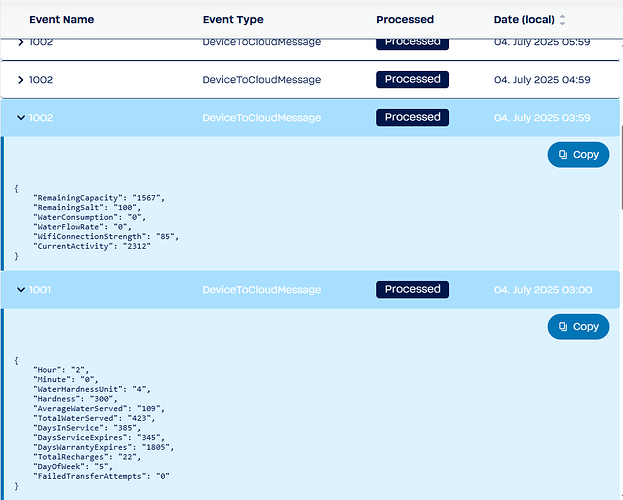

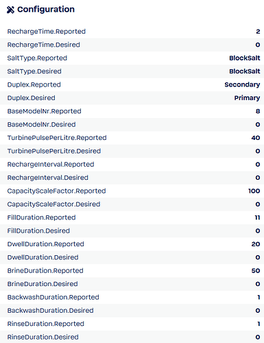

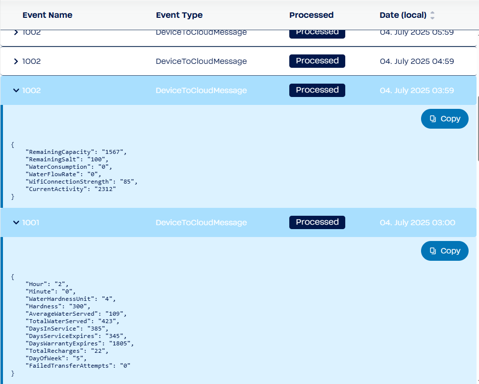

These are some screenshots I managed to get from BWT UK customer support.
These are all my findings so far.
Index Value Meaning Notes / Confirmation
0 0 Salt Type Likely: 0 = Tablet salt. Could be enum.
1 -1 Unknown / Reserved Possibly unused or uninitialized.
2 23 Current Hour (UTC) :white_check_mark: Confirmed: Matches your local time (BST = UTC+1).
3 40 Current Minute (UTC) :white_check_mark: Confirmed.
4 300 Water Hardness (ppm) :white_check_mark: Matches cloud data (“Hardness”: 300).
5 30 Unknown – Possibly firmware or config ID Needs further confirmation.
6 17 Unknown – Possibly status flags May be a mode bitfield.
7 2 Recharge Time - Hour (UTC) :white_check_mark: Confirmed: You set this manually to 02:00.
8 0 Recharge Time - Minute (UTC) :white_check_mark: Confirmed: Matches recharge setting.
9 9 Unknown Might relate to recharge interval or other config.
10 8 Base Model Number :white_check_mark: Matches logs and cloud telemetry.
11 1 Duplex Setting 1 = Duplex mode enabled? Confirmed in message logs.
12 8 Unknown Possibly same as model ID. Needs clarification.
13 4 Turbine Pulses per Liter :white_check_mark: Confirmed. Used in flow metering.
14 109 Avg. Water Served per Day (litres) :white_check_mark: Confirmed. Matches cloud data.
15 426 Total Water Served (litres) :white_check_mark: Confirms summary message (totalServWater)
16 0 Failed Transfer Attempts :white_check_mark: Confirmed from cloud data.
17 387 Days in Service :white_check_mark: Matches daysInServ in cloud data.
18 1803 Warranty Days Remaining :white_check_mark: Matches cloud info.
19 22 Total Number of Recharges :white_check_mark: Confirmed.
20 40 Possibly recharge delay duration Might also relate to service schedule.
